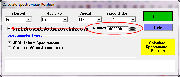

I'm releasing a version of CalcZAF that has a new window (see Xray | Calculate Spectrometer Position menu in CalcZAF) for calculating spectrometer positions for both JEOL and Cameca instruments as seen here:
To improve this calculation I'd like to:
1. Get suggestions of other spectrometer geometries (different Rowland circles) to implement...
2. I think we should "crowd source" an effort to refine the refractive index values for the light element spectrometer crystals such as PC1 and LDE1 to improve the accuracy of KLM markers on our spectrometer scanning plots.

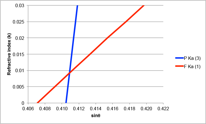

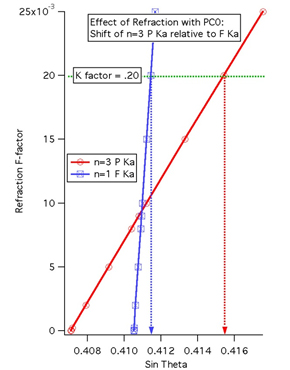

By the way, I checked John Fournelle's early calculations and I'm confused.  Did the graph labels for F ka and P ka III get swapped or did I screw up the calculation...?
The point is, John Fournelle made this graph some some time ago, and he showed that depending on the value of the PC0 refractive index, the P Ka 3rd order line will show up on one side *or* the other side of the F Ka line (and hence the corresponding spectral interference position!). But the F ka line in my calculation shows the larger change compared to P ka 3rd order for different refractive index values.
Anyway, is the refractive index of a PC0 (45 angstrom 2d) really 0.02?  According to John F.'s measurements, the answer is yes.
Here is the calculation from the new CalcZAF window:
Spectro position for f  ka on PC0 (160 mm), is 41542 (with refractive index correction, k= 0.02)
Spectro position for p  ka (III) on PC0 (160 mm), is 41145 (with refractive index correction, k= 0.02)
The point is that with a large enough refractive index (0.02), the P Ka 3rd order line will shift relative to the F Ka 1st order line, enough to fall on the other side of the F Ka position!  E.g.,

Edit by John: Ok, as Julien has confirmed in the next post, John Fournelle's plot labels in the graph above are reversed.
Julien
I agree with John D., I think the label for P Ka (n=3) and F Ka (n=1) in John F. graphic have been inverted. The opposite should be observed. I have recompute the same calculation, and here is the result:

Ok, new version of CalcZAF (v. 10.5.3) allows us to "play" with the refractive index to see the effect on spectrometer position.
Edit by John: using this dialog one can calculate nominal spectrometer positions for JEOL (L-value) and Cameca (sin theta) with or with the Bragg refractive index effect.

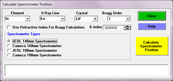

BTW, do you have an option in CalcZAF for the 100 mm Rowland circle on JEOL (H-type spectrometer)? I'm surprised Paul would not have asked you that already, as it seems he is a great fan of these spectrometers that can give up to 6x more counts than a regular spectrometer with small area crystals...
J.
Quote from: Julien on November 22, 2014, 12:14:31 PM
Yes, with some tradeoff in spectral resolution.
This suggestion is exactly what I am looking for.  See point #1 in this post:
http://smf.probesoftware.com/index.php?topic=375.msg1971#msg1971
So 100mm Rowland for JEOL.  Any others I should add?

Yes, please add Cameca 180 mm spectrometers.

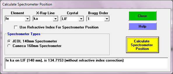

Quote from: Philipp Poeml on November 24, 2014, 01:55:49 AM
Of course since Cameca spectrometers read out directly in sin-theta units, the spectrometer positions for the 160 and 180 mm FC spectrometers are the same.
In fact even JEOL has the 100mm spectrometer positions read out as though they were a 140mm Rowland circle spectrometer (according to Paul Carpenter JEOL seems to be handling the difference in the spectrometer micro-code)- because of course they should be different in L-unit values!).  Anyway, I added them to the list to make that clear as seen here:
Here is the output for all 4 options for Fe ka:
Spectro position for fe ka on LIF (140 mm), is 134.7153 (without refractive index correction)
Spectro position for fe ka on LIF (160 mm), is 48113 (without refractive index correction)
Spectro position for fe ka on LIF (140 mm), is 134.7153 (without refractive index correction)   <-  should say 100mm but it's as though it was a 140mm!
Spectro position for fe ka on LIF (180 mm), is 48113 (without refractive index correction)  <-  should say 180mm but it's as though it was a 160mm!
