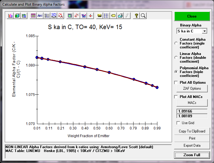

1. When you quote alpha 1, 2 & 3, just what is the form of the expression these feed into (dumb bunny question)
No problem. Attached below is an abstract just submitted for AMAS 2015. You might also want to check this link for a historical background:
http://epmalab.uoregon.edu/bence.htm

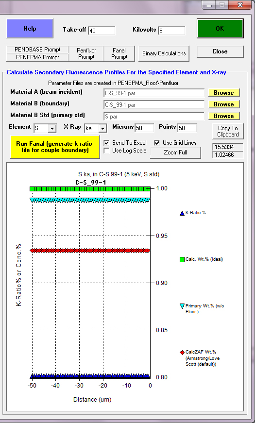

Ok, the C-S binary run in Penepma finished the first composition which just happens to be one of your compositions, that is, 1 percent sulfur in carbon (skill not luck!).  ;)
If I read your questions correctly, as you can see, both CalcZAF and Penepma agree closely (the red and green symbols), the matrix corrections are a relative non-issue (CalcZAF = 1.08, Penepma = 1.07) at 15 keV. I attach a detailed Excel output for the calculation below.
Now at 5 keV, the situation is... what just a darn tootin' minute! This is interesting: the matrix correction for 1% S in C is quite a bit larger at 5 keV than 15 keV, quite unintuitive!  See here:
I attach the 5 keV Excel sheet below also.  I have to admit, this is surprising.  If we just look at CalcZAF here are the 15 keV data:

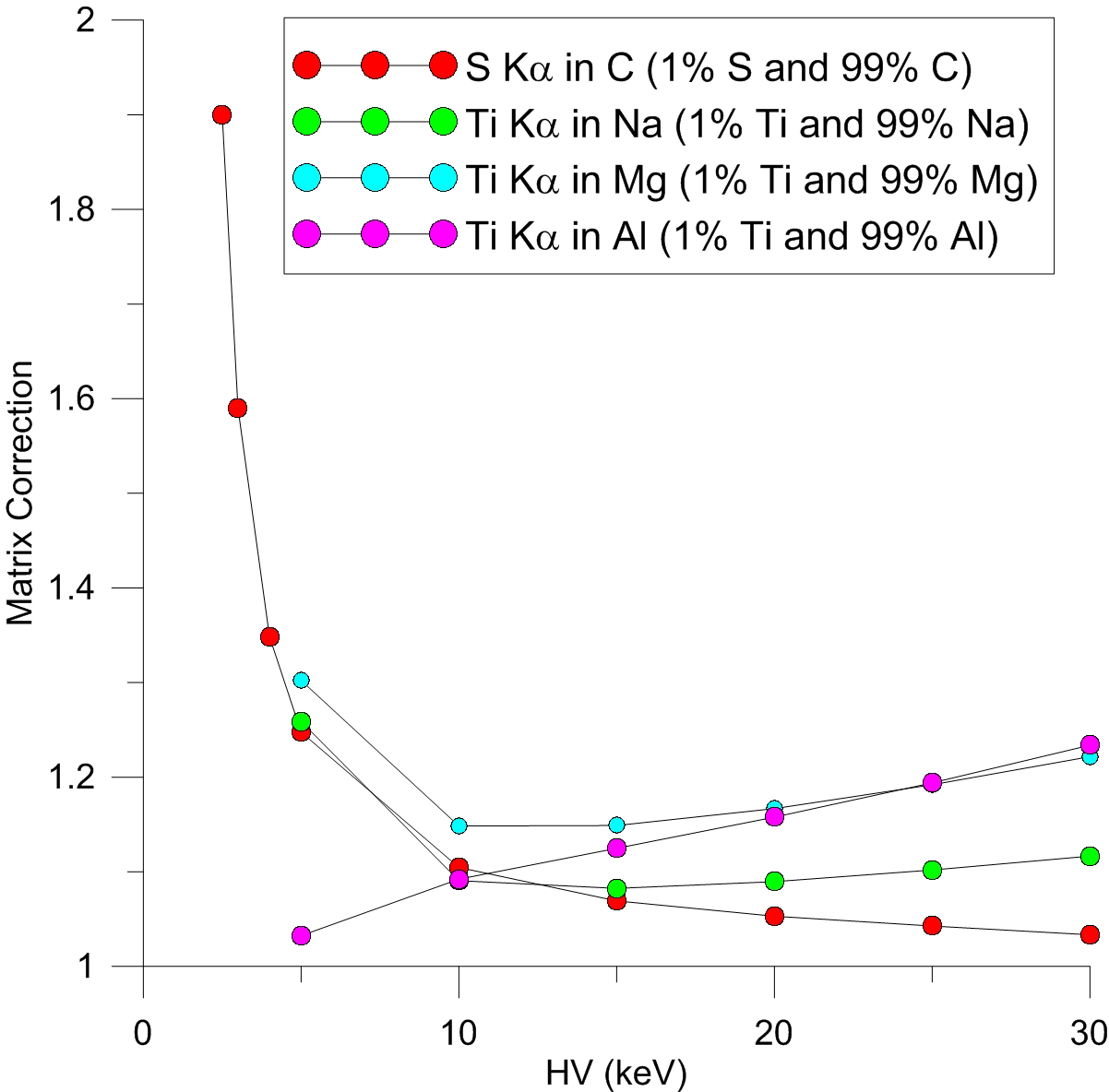

So let's plot of the matrix correction vs. HV for a number of 1% emitters in a 99% matrix using Penepma (Penfluor/Fanal):
I'm having some difficulty explaining these results but maybe there is a physicist "in the house"?

The first set of calculations are from the Penepma/Penfluor Monte-Carlo calculation GUI in Standard.exe and the 2nd set of calculations are from analytical calculations from CalcZAF.
The C Ka matrix correction calculations at 5 keV are in almost perfect agreement (1.02), but yes the S Ka at 5 keV are a little different (1.24 vs. 1.16), and the physics is, as I said above, weird.
Frankly I trust Penepma a little more (especially when it gets "weird")...   ;)

The column headings are explained in the Probe for EPMA reference, just hit the F1 key in any of my apps and search for Penepma.
In the Penepma Penfluor/Fanal GUI, because it was designed for calculation of secondary fluorescence effects at boundaries, A refers to the beam incident material and B refers to the boundary material.
However for the purposes of the matrix correction calculations, we simply specify the same material for *both* material A and B and then we get a *matrix* calculation...  cool!   8)
So for the two spreadsheets attached above (here):
http://smf.probesoftware.com/index.php?topic=47.msg2016#msg2016
both are S Ka in carbon, one at 5 keV and the other at 15 keV.
See here for easy modeling of matrix effects in Standard.exe:
http://smf.probesoftware.com/index.php?topic=152.0
