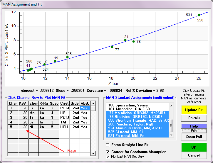

Really like the new graphics, they look snazzy. I also like that the sample numbers don't sit on each other in the MAN box. Is there a reason I can't zoom in on areas with the mouse click/drag box on the MAN review window now? I can still do this on the Plot window fine, just don't seem to be able to do it in the MAN box...
cheers
Thank-you!
Indeed. I never thought anyone would want to zoom there, but sure- why not add zoom to the MAN plot?  It's a few lines of code and a button for "zoom full".

The latest version of Probe for EPMA (v. 11.3.3) has zoom capability in the MAN fit plot dialog as seen here:
https://smf.probesoftware.com/index.php?topic=71.msg4069#msg4069

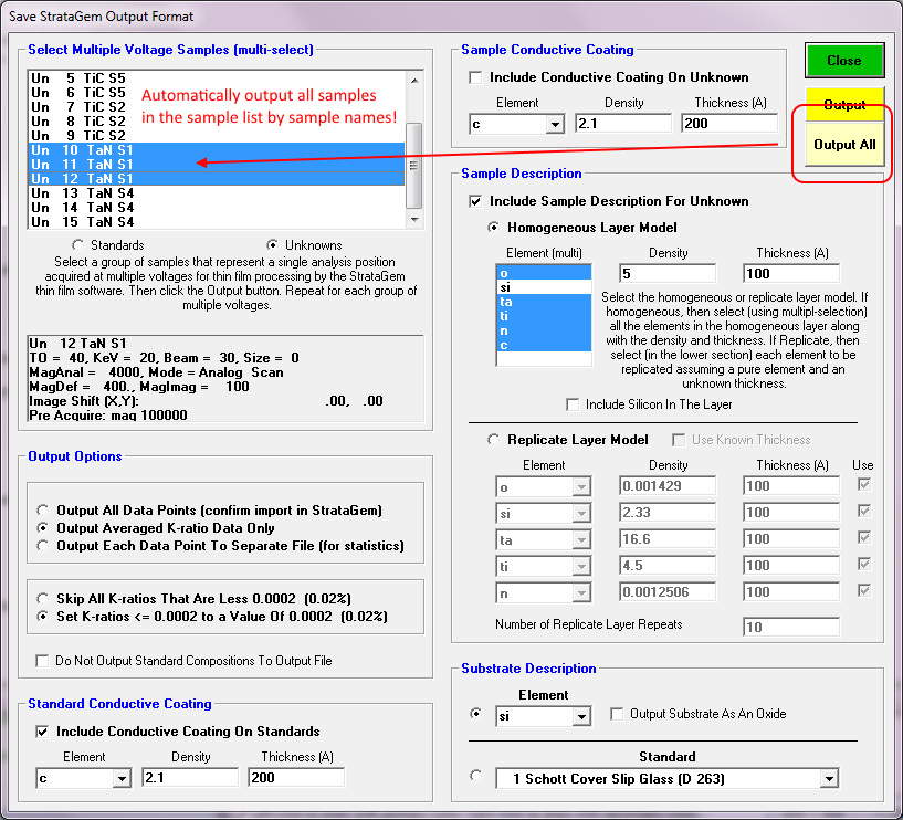

I added an Output All button as seen here for the thin film output:
This feature then automatically selects each multi-voltage acquisitions with the same name and exports the k-ratios and film geometry for thin film quantification.
This will greatly speed up thin film reprocessing I suspect.

Awesome, thanks. I find it handy if I can zoom in to the lower Z end of the spectrum to see how good the fit is when you are dealing with low level elements and using MAN.

I understand.
Or what I do is to analyze a low Z pure oxide that is not used in the MAN fit to check for zero.  In others words, a blank standard.   If the blank matrix is similar to one's unknown, then it is a robust check.
What is your matrix?
In version 11.4.0 of Probe for EPMA I modified the MAN dialog to automatically load all MAN elements for all keVs in the run.  This way, combined condition samples using MAN backgrounds now get handled automatically.  Thank-you Anette!
Here you can see that I've removed the "Re-Load" button and associated takeoff and keV controls and added a column for KeV:
Note that both the element takeoff and keV are now stored in the MAN table so one can have different curves for the same element setup at different keVs.

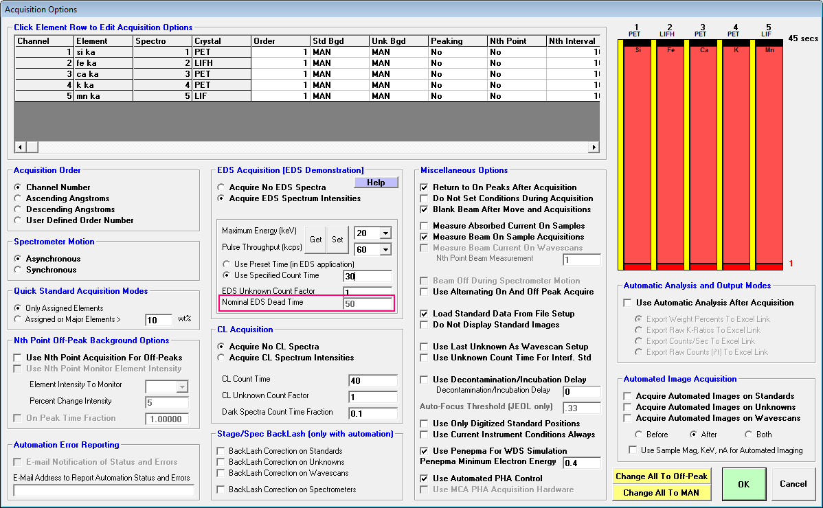

The latest version of Probe for EPMA now includes a new text control in the Acquisition Options dialog, for the user to specify the "nominal" dead time of the EDS system as seen here:
By "nominal" we mean the approximate EDS dead time in percent. The default is 50% and please note that this text control cannot be edited in demo (simulation) mode as the Penepma based Monte Carlo EDS "acquisition" has no dead time!
This nominal dead time value is stored in your current probe run MDB file, but is only utilized to estimate the acquisition time for the EDS system.
