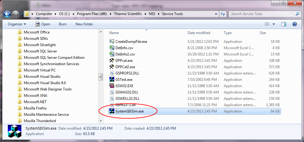

You have SystemSixSimulation also highlighted there for exception. I assume this is special to you, as I do not see it on my computer. Nor any other app besides TEPortal which sounds like thermo-related.
Quote from: JohnF on December 26, 2014, 01:03:20 PM
Yes, the SystemSIXSim.exe is for demo testing, but my Sx100 does have the TEPortalsvr as an exception but nothing else, probably because PFE and Thermo NSS are on the same computer. I'm sure Thermo will help you set this up.
