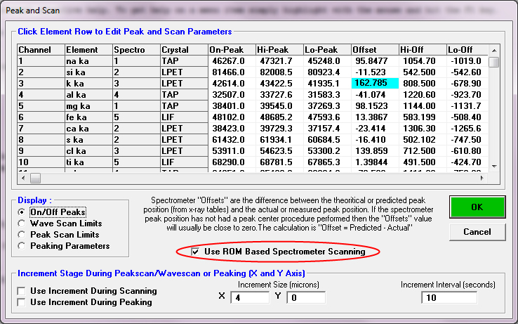

How do you "turn on" the greyed out 'use rom peaking' for the _post-scan_ option in Peaking?
Quote from: JohnF on January 31, 2015, 05:42:33 AM
Sorry, that is an oversight that is easy to fix.  It should "enable" if either of the Pre/Post options are checked.
In the mean time there are several other places to toggle that option as it is a global. Here's one:
I will upload a new version today anyway.
