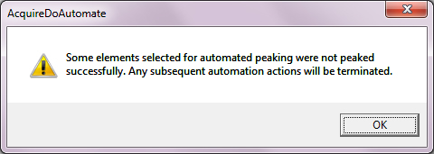

#114
Quote from: Probeman on May 26, 2015, 08:07:11 AM
Quote from: Ben Buse on May 26, 2015, 12:54:50 AM
Yes I thought it would say no and abort. But in this case it did the fine peak scan with the centre of the peak just outside the window, then it did the course peak scan with the centre of the peak just outside the window. Then it said peak failed (can't remember wording), but that it would use previous peak position and changed peaked to yes. It may well be because the coarse scan was set up wrong looking at it now the range had been set to small - I will change this
Hmmm, still it should not proceed with the standard acquisition if there was an error with the peaking.  I'll look into this  as well.
The automation "trap" for unpeaked elements seems to be working.  Here is what I get when one or more WDS elements fails to peak:
In the log window you should see something such as this:
ROM Brent's Maxima Peak Center Results (cps):
Element  Spectr  Peaked   StartPk    StopPk     Std  Offset    StartI     StopI StartPB  StopPB
   rb la   2 LPET   *No     83850.4   .000000    1023   -201.     445.8        .0    3.56     .00
   sr la    1 PET   Yes     78575.2   78508.5     251    -65.    4975.2    5033.8  178.76  180.86
This may be a subtle issue, so let me know if you are still seeing a problem.
