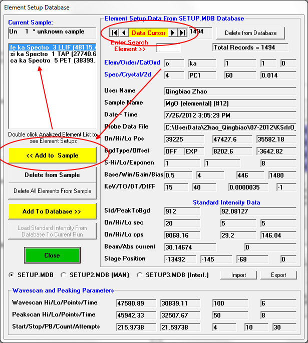

I have a small wish that I don't think has been mentioned yet, and it is regarding adding an element to a run that has a multi-point background via the "Load Element Setups" button. If you add it to your run and decide to change the spectrometer that it is going to be run on, it wipes all the MP background positions and defaults to analysing it via 2pt linear. Now I understand the reasoning behind this, but for example sometimes I am moving it from a LPET to another LPET and I know that any slight difference in potential interfering peak positions from one crystal to another is going to be inconsequential on the background positions. At the moment I am manually writing the MP background positions down, changing the crystal number, then manually readding the background positions. Not sure if its possible but it would be great if it kept them when switching crystals...
Well, I have to agree you have a point here, unless the peak positions differ by too much (as do a couple of my crystals), it makes sense to allow this.
But I need to think of a clever way to do it.
By the way, they are not visible, but the multi-point background positions and other parameters are stored in the element setup database (SETUP.MDB) so once they are stored, they can be easily recalled into a new run one element at a time...

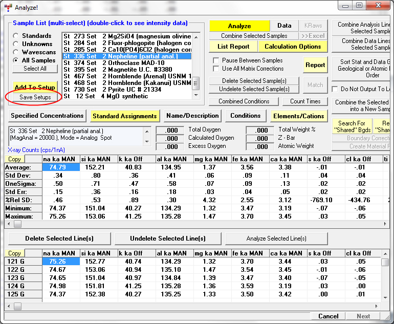

But also, the easiest way to automatically store all your element setups and standard intensities for general re-use (you can always load a complete file setup obviously too), is by using this handy Save Setups button as seen here:
If you click this button, the program will search the standard assignments for each element and save the element setup and standard intensities, including all MAN and interference standard intensities with one click!   8)

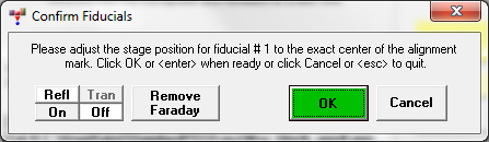

New request: add a light on/off switch for the verify fiducial marks, thanks!
Quote from: jeb on October 01, 2014, 04:15:21 PM
Your wish is granted!

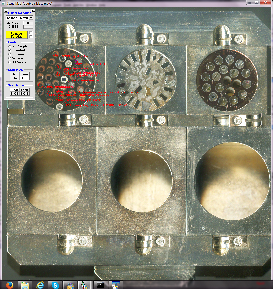

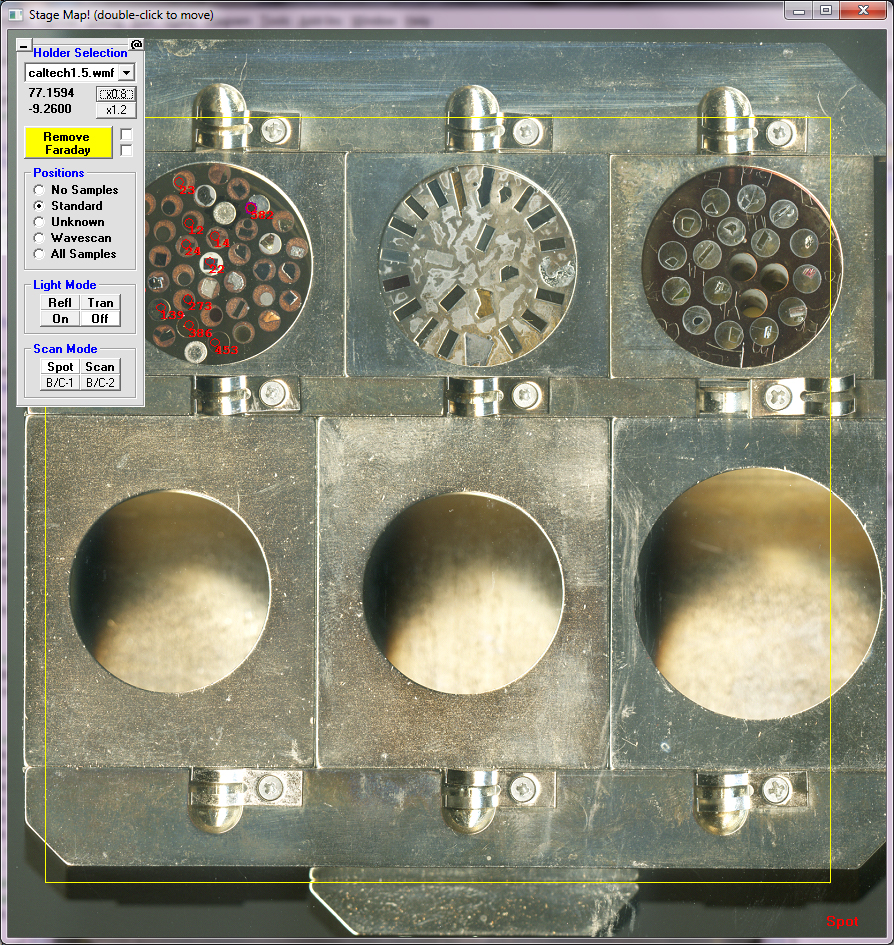

Ok, I added the standard names to the StageMap but only when it is at 150% original size. Note that as it is resized smaller, first the standard names disappear and then the standard numbers.
Here is the large size showing standard names:
