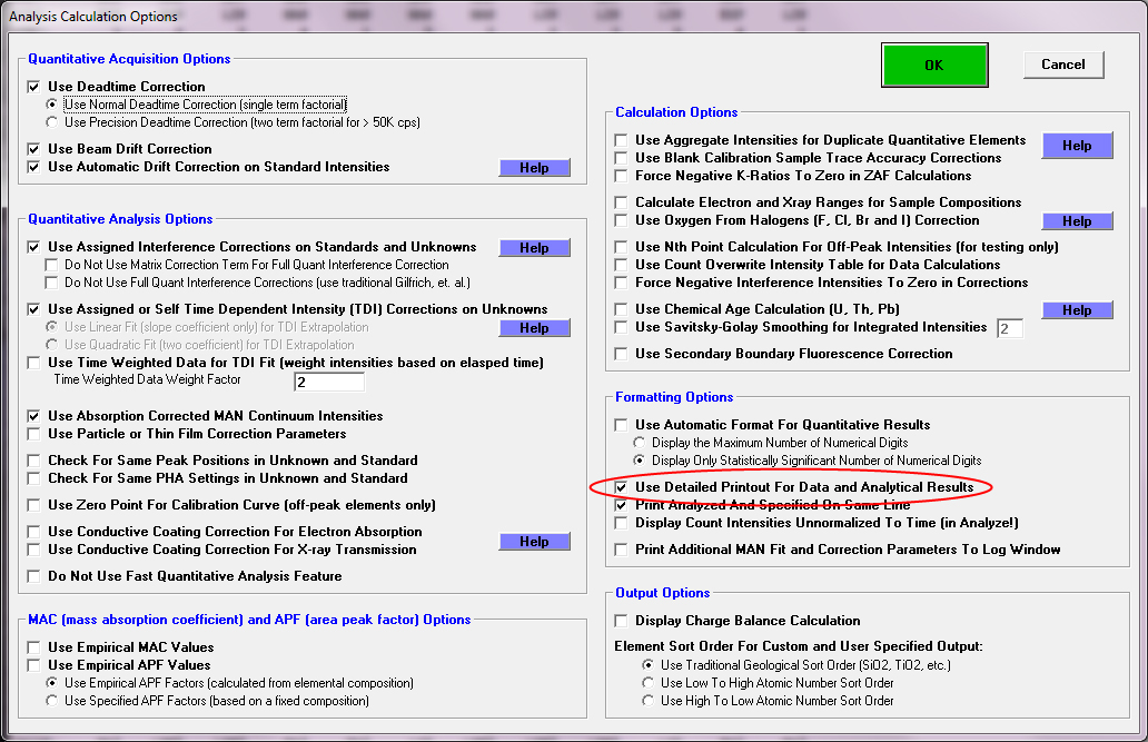

Quote from: Anette von der Handt on July 09, 2014, 10:00:51 AM
Both the JEOL and the Cameca software have a one click option that gives me the set-up...
Oh, those are "fighting words"! ;)
Seriously, it would be easy to add, but you know you do get the complete sample setup displayed to the log window when you click the Data button as seen here:

But, note that you need to have this box checked to get this output as seen here from the Analysis Options from the Analytical menu:
But I will add your requested items to the Analyze! Report output so that it will be tab delimited for import into Excel or Word...
