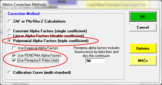

The Penepma derived matrix correction factors stored in the MATRIX.MDB file have had their access time significantly improved by implementing a new index in the matrix database.
These Monte-Carlo derived k-ratios may be utilized for high speed on-line matrix corrections or model testing and are accessed from the Analytical | ZAF, Phi-Rho-Z, Alpha Factor and Calibration Curve Selections menu as seen here:

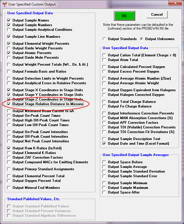

small things. Could you maybe add the "relative line numbers" option to the "save user specified format output", please. It is the only thing I am missing there but it would be very useful.
I also wondered if the "report" output in the Analysis window is customizable? Ideally, I would like to have our Department name in there and maybe a grant number? Maybe also an auto acknowledgement? So I wondered if there is a text file that is read out or if there could be something like that.
Thanks.
Quote from: Anette von der Handt on June 06, 2014, 04:06:38 PM
Excellent idea. I will add that.  In the meantime you can utilize the "Stage Relative Distance in Microns" output as shown here:

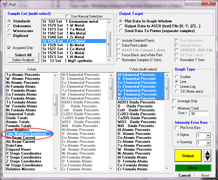

or even the Relative Line Numbers output from the Plot! window:

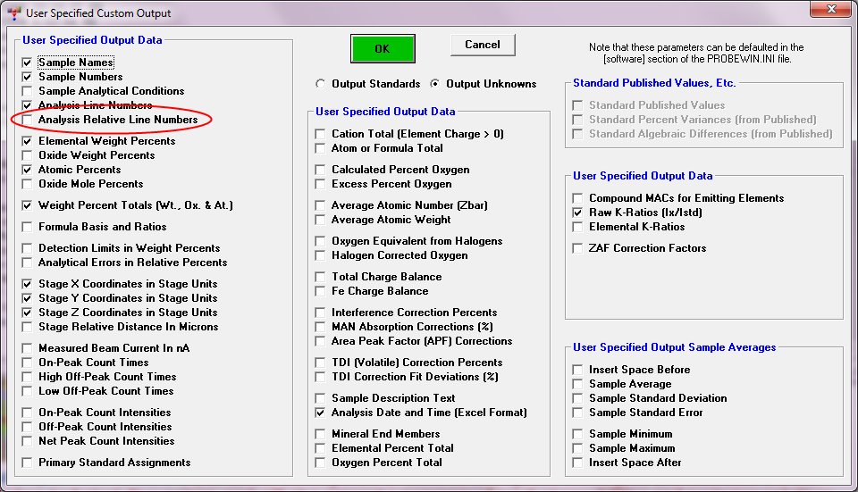

Your wish is granted!
I also reformatted the dialog and tried to make it more readable...

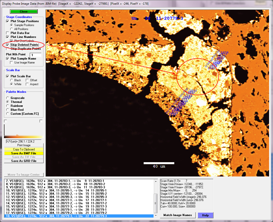

(2) when a collected unknown sample has been "deleted" from the run, I don't want the analysis spots to still show on the image collected... I think they do...
Thanks John!
#54
Quote from: jeb on June 23, 2014, 11:23:06 AM
(1) the ability to change the order that positions are in (just like you can change the order that samples are analyzed in, I would like to be able to change the order of the individual analysis positions).
Ok, it is possible. I just have to think of a nice and intuitive way to do it.  In the meantime, for the purposes of running every other point in a traverse, simply make a copy of the position sample (see the Duplicate As... buttons in the Position window), and delete all the odd numbered lines from one position sample and all the even numbered lines from the other (using a right mouse click on the position grid from the Automate! window), and that will do what you want for the quartz traverses.
That is easy- see this control in the Image Display dialog:
Now, without the deleted points:

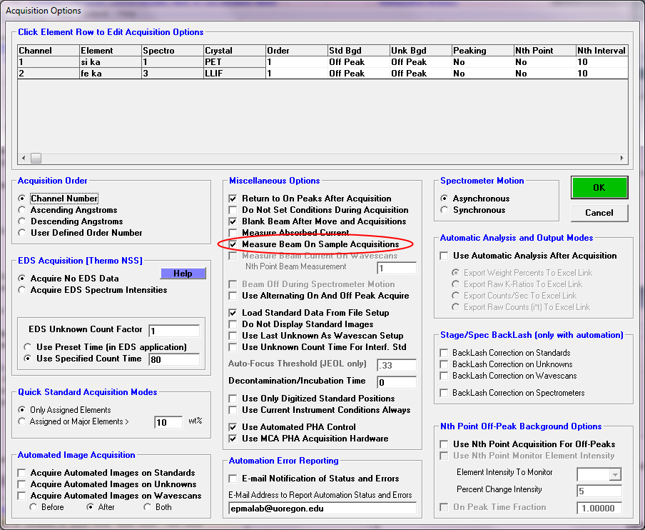

More of a question than a request, but in Automate, is there a way to have PFE not blank the beam when moving from one position to the next?
May I ask why you want to not blank the beam between position samples?
Gareth D Hatton
One reason I can think of is to do polygon mapping using point analysis.  If you set the count time to a low time, around 1 second per point, and aquire lots of points then you could have a reasonable map avoiding specific areas.  However, the major overhead in this analysis is the beam blank between points, it takes about 3 seconds.  This makes it a little impractical for high speed but fine if you use a longer dwell time.
Quote from: Gareth D Hatton on June 26, 2014, 04:16:58 AM

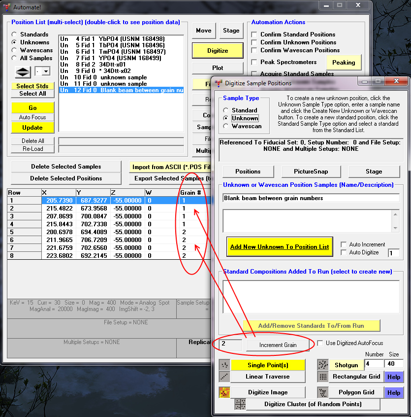

Something isn't right. The software is already designed to not insert the cup when moving between points in a single position sample...  oh, maybe you are just seeing the beam current measurement at the end of each analysis? You will need this beam current measurement for the beam drift correction.
In fact, there is an option in the Digitize window to *force* the faraday cup to be inserted for moving between points in a single sample, by incrementing the "grain number" as seen here:
So because the "settling time" for the JEOL picoammeter is quite long (and seems to be getting longer with each new probe model!), we have some additional overhead if we want to have our analyses beam drift corrected.
Of course, if the probe is very stable or beam drift isn't a problem then you could disable the beam measurement during sample acquisition by unchecking this box in the Acquire! | Acquisition Options dialog:

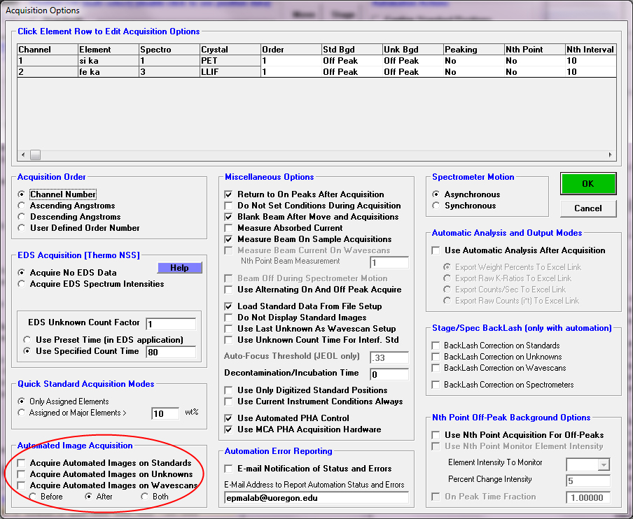

Actually hadn't thought about that one, but it's a very neat idea. I was more thinking about doing a Confirm a long list of samples, or using Automate for imaging. For example, we do a fair amount of zircon CL imaging, where we import the coordinates into Automate from the ICP laser stage. Automate/Fiducials makes loading the positions and moving around very easy, but 3-4 seconds of PCD insertion/removal for every motion adds up when imaging 1000 zircons (not to mention the extra 1000 mouse clicks, if you're taking the pictures manually).
Again, was more just wondering if this was possible - if it isn't, then it isn't.
Considering that the image acquisition takes a lot more than 3-4 seconds, I don't see your point.
As I said, the cup insertion is for measuring the beam during analyses.  I'm pretty sure I modified the code so that the faraday wait in time is *not* applied when just moving the stage, only when measuring the beam current.
Also you might check the acquire images option in Acquisition Options, that way your images are acquired automatically during the unknown acquisition as seen here:
