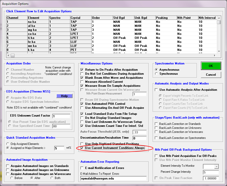

I also pulled the keyword into the GUI, so you can change the Use Current Conditions Always flag "on the fly" as seen here:

Simply enter an email address and check this box here in the Acquisition Options dialog from the Acquire! window:
The cool thing about this feature is that it not only informs you if an error has occurred during the automation (e.g., blown filament), but it also sends you a progress report every 8 hours and also sends a final notice email when the automation is complete!   8)
