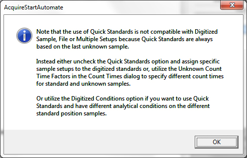

it seems that one cannot use "quick standards" with "digitized sample setups".
To use the combination would be super useful. Could you implement that?
Philipp
Quote from: Philipp Poeml on December 02, 2014, 12:58:17 AM
It seems that one cannot use "quick standards" with "digitized sample setups".
I assume you are getting this message?
Actually it gets very complicated... can you tell me what exactly you are trying to change in the standards by using sample setups? If it's just the analytical conditions, as the message says, you can use "quick standards" with the Automate! Digitized Conditions acquisition option.
Also be aware that "quick standards" have some nice options themselves in the Acquire! | Acquisition Options dialog as seen here:
http://smf.probesoftware.com/index.php?topic=8.msg1095#msg1095

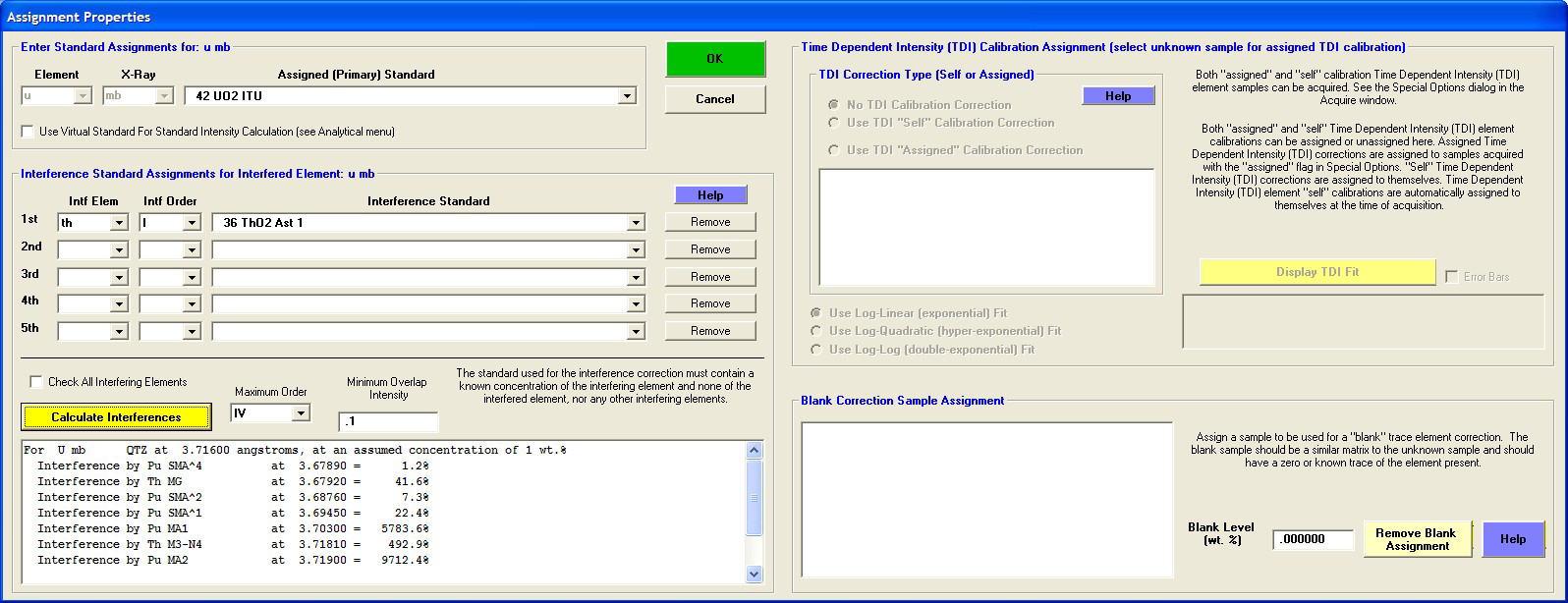

1) Would it be possible to have another function where I can first include/exclude elements and then get a list of the filtered standards with their Z? Seems to me just like a combination of what is already available in the program..
2) In standard.exe, I can check for nominal interferences in a given standard composition. However, I cannot choose to specify an element which is not in the element list of the standard. It would be great if I could just choose random elements to quickly verify that I do not have a peak interference in my MAN standard.
I understand #2 well enough. Remember though, the nominal interference calculation assumes Gaussian overlaps and so is not very accurate.
The best practice in my mind is to simply acquire all analyzed elements in all standards (the default non quick standards), and then analyze them (as if they are unknowns from the Analyze! window) and see if anything shows up that shouldn't be there.
Actually even easier is to simply unselect any standard intensities that plot above the general MAN curve trend. After all, background is *by definition* the lowest intensity one can measure, so if the std intensity point is above the trend, it's either a contamination or an interference and you really don't care which it is- just deselect it from the fit.
This certainly works well but in terms of efficiency (time=money) I rather would like to not spend time acquiring data I ultimately will not use. Just having access in this dialogue to the list of nominal interferences would serve as a nice guideline to weed out the obvious non-candidates.
Quote from: John Donovan on November 18, 2014, 10:08:12 PM
As for #1, maybe you should provide an example of what you mean.
Let's say some user wants to map some multi-phase material with a wider spread of mean Z for various major and minor elements, in total 10 elements. And our metal standard block is in a somewhat rough shape ;),  the user does not know our various standards by heart and I, microprobe mastress, am not around. And time is money again (see above).
Right now standard.exe allows me (1) to look up standards that contain a certain element (Find..) or (2) to list all standard names and average Z and. I just thought having the option to combine (1) and (2) in one output or - for the purpose of MAN backgrounds - exclude (rather than find) standards containing a certain element(s) and then list their name and Z.
However, I am aware that I could probably create an excel spreadsheet that would contain this kind of information, so overall this function would be a "nice to have".

Yes, that is the message I get. I am trying to measure standards and unknowns in one run and also remeasure the standards after a certain time. For this I need to:
*change the beam current
* change the counting times of some elements
* change the beam size
* set some elements to "acquisition-disabled" (and later re-enable them)
I figured the best way to do this is using "digitized sample setups".
Now, without quick standards, I waste A LOT of time for analyzing all elements over and over again...

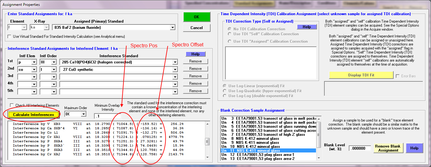

Quote from: Philipp Poeml on November 26, 2014, 11:33:42 PM
Why not display spectro units here (screenshot)? You do that for the off peak interferences. Nice would be also spectro units relative and absolute... Also in calczaf.exe where I do these calculations from time to time.
Edit by John: Your request has been implemented in v. 10.5.4
Great, John, thanks a lot. Now, the next wish:
A little tick box: "Tick this box to see the interefence lines in realtive spectro position offsets from the peak".
Would be SUPER handy!

Quote from: Philipp Poeml on December 02, 2014, 11:44:46 PM
Here's what I would do:
1. Set up the counting times on the standards and unknowns differently using the unknown count factors in the Count Times dialog, see here:
http://smf.probesoftware.com/index.php?topic=29.msg397#msg397
2. Using the Digitized Conditions dialog in the Automate! window, specify one set of beam currents and beam sizes for your standard positions and different conditions for your unknown positions.
3. Select "Use Quick Standards" in Automate!
4. As for "Acquisition disabled" flags- go ahead and set them, and then unset them later!
That is all you have to do for your list above!

this unknown count time factor is a really cool thing I did not know about. I will check it out. Thanks.
However, I don't see how I can enable/disable elements using your proposal. I am measuring some standards for some virtual standards, and I don't want to waste time measuring these standards of elements that are not present in my sample on the unknown.
I really would like to use the sample setups with "Quick Standards"!! Would solve a lot of problems.
Edit by John: I can understand, but the code is very complicated in this regard and I'm just one guy! Let me think about it and maybe I'll come up with something cool and easy!
Your wish is granted (no need for a checkbox)!
