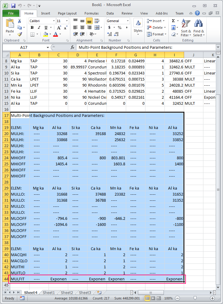

OK, we added some code for output of MAN (mean atomic number) background fit assignments and MPB (multi-point background) parameters. Here is the output to Excel for MAN assignments:
Add here is the output to Excel for the MPB parameters:
Let us know if you need it formatted differently. Update PFE from the Help menu as usual...
We decided to modify the MPB fit type output to show the "Linear", "Polynomial" and "Exponential" strings instead of just the integer index as shown here:
Again, update from the Help menu to obtain this latest version.

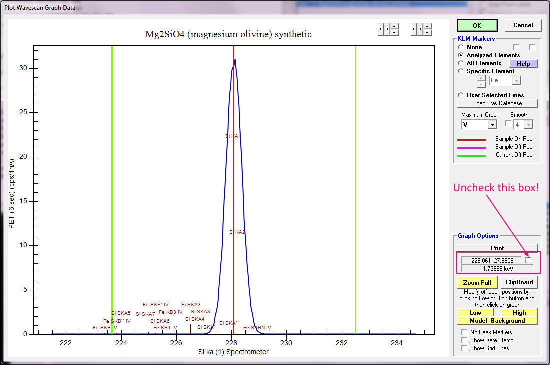

We often use the wavescan function to identify the peak position for S on vg2, with ca. 1000ppm,
Would it be difficult to have a peak fitting function - to read the peak position within the plot window?
Well, you can either uncheck the "Relative Position" checkbox in the Plot! window and use the mouse cursor to display in spectrometer units, as shown here:

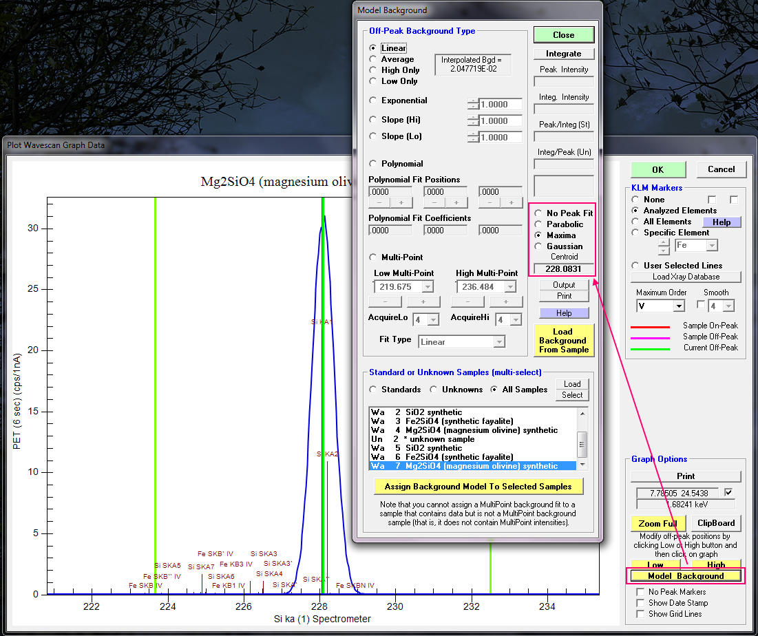

Or you can use one of the peak fitting methods in the Model Backgrounds dialog as seen here:
#471
Thanks, you learn something new everyday.
So it fits a function to the whole wavescan range is that right?
So Parabolic and Gaussian only work if wavescan range is restricted to the width of the peak, whereas Brent Maxima always works, as its using a parabolic interpolation to find the maxima -

OK, we modified the code to utilize the x-axis "zoomed" range if the plot is "zoomed", and if not, just use the full wavescan range (as before), for the centroid fitting:
This version is v. 12.9.0 and just update as usual from the Help menu in PFE to get it.

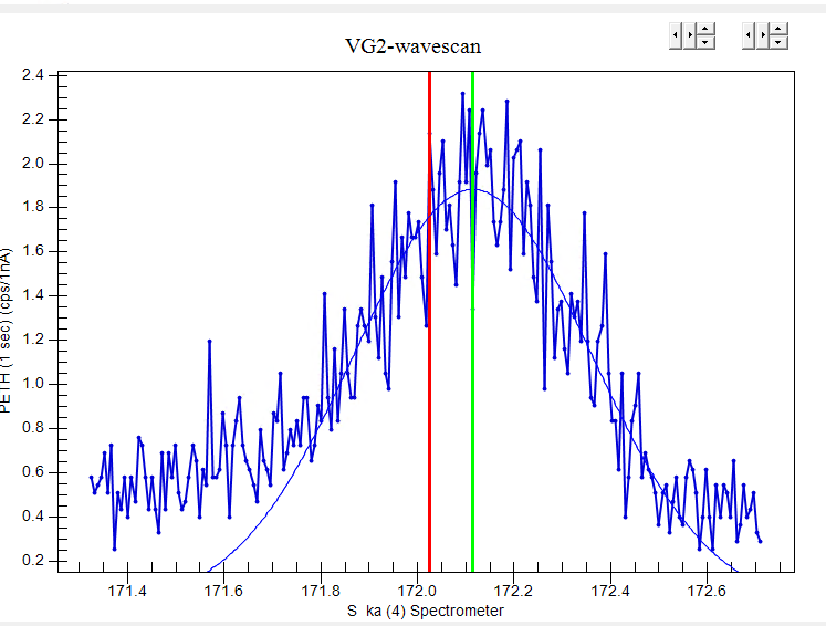

Thanks John,
This is great
I've included an example below - I zoomed in, applied gaussian fit, then zoomed out

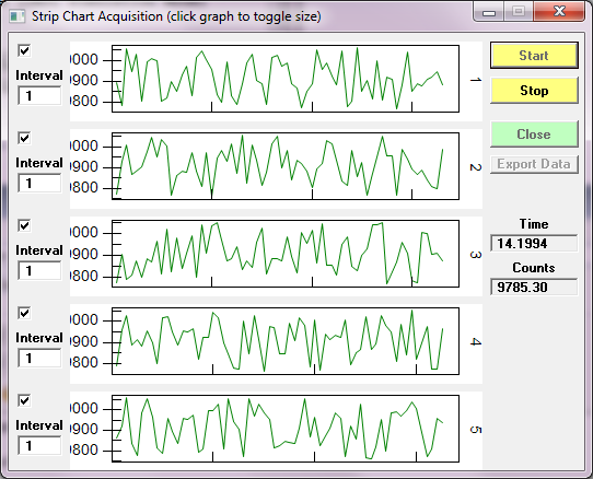

I am not sure if I requested this before and there was a practical problem in implementing it or I never voiced it before.
I wish that I could keep a spectrometer stationary during wavescan acquisition. Essentially, that there is a check box in the peak/scan options dialog that would have the spectrometer move to the peak position and then just acquire the intensities in the time interval steps without moving the spectrometer itself. I then just use the line number as X-axis to visualize any change in the plot window.
Idea behind it would be that while I run a wavescan on 4 spectrometers I could monitor carbon contamination or Na loss on the 5th spectrometer. What do you think?
There's a StripChart.exe app in the TestProbe.msi installer.
Maybe that will work for you?
