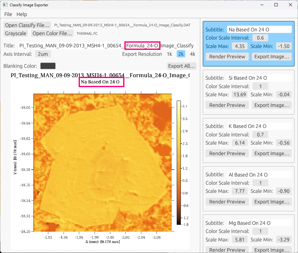

What we did was hire a developer (Mia Kraft) to write a small app that can take a "Classify" DAT file from CalcImage quantification and create images with XY scales and a data color scale. The app is called Classify Image Exporter and can also be run by itself or from a menu in CalcImage.
Here is the new menu in CalcImage v. 14.1.9:
Note that one can select any "Classify" output file (oxide, atomic, formula, etc.) from CalcImage, and the Classify Image Exporter app will allow one to customize the XY tick marks, data scale and blanking color (for those maps with blanking values) and export them to PNG or JPG files:

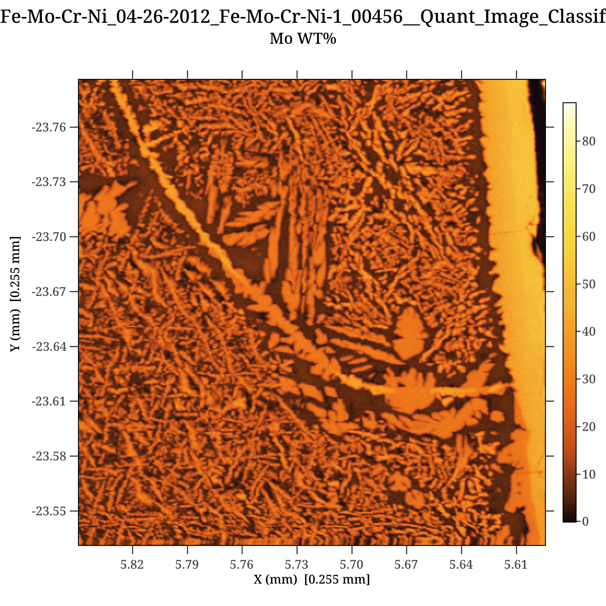

Here's an example of a 2K export:

This is really nice, and will be very useful. It's great the way you can set max and min colour, title and subtitle before exporting.
Mia Kraft
Just as an extra note, you can change the file extension, or selected one from the drop-down menu during export (Just under the file name).
Currently supported file types are: PNG, JPEG, TIFF, WEBP, and BMP.

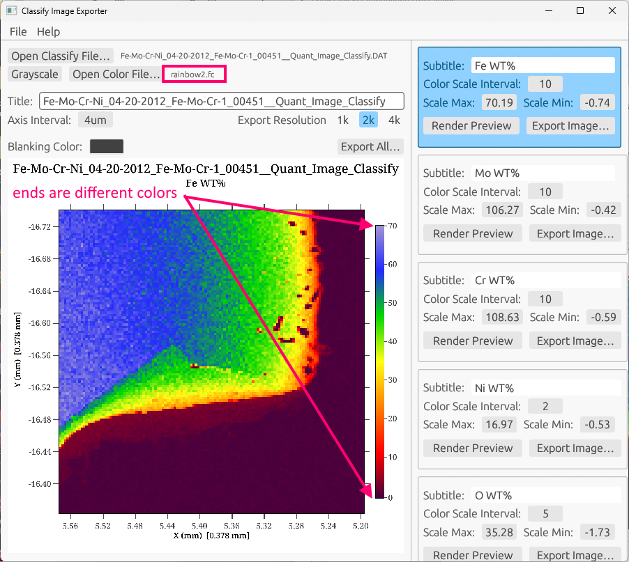

Color palettes are non-intuitive- at least to me!

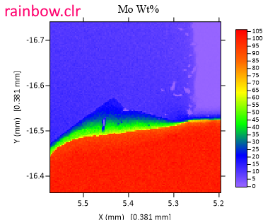

When we first started our quant mapping software I created a color palette which we called rainbow.fc:
Now one can point out, as many have, that we shouldn't even be using "rainbow" palettes in the first place, because they are not intuitive for a couple of reasons at least:
https://smf.probesoftware.com/index.php?topic=1003.0
First, if you have black on both ends of the palettes it can be hard to tell what color is high and what color is low. I choose to modify the typical rainbow palette and remove the black colors as seen here:

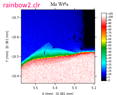

But, probably because I'm such as nerd, this rainbow2.fc file has red as the low values and blue as the high values... because blue is a higher energy photon, right?  Hey, it made sense to me at the time!
However, Golden Software has a different perspective. They made blue the low values and red the high values:
and here is their rainbow2 CLR file:
which I personally like because black is the low value and white is the high value, though it still has blue colors as "lower" than red values.
In the past, we defaulted the Surfer palette to use the rainbow2.clr file, because it seemed more intuitive, but starting with v. 16 of Golden Software's Surfer app, they stopped providing discrete .CLR files, except for the rainbow.clr file.
So when we run Surfer scripts they now default to rainbow.clr instead of rainbow2.clr.  But now we've created a rainbow2.clr file (attached below) which you can copy to your v 16 Surfer application folder, usually C:\Program Files\Golden Software\Surfer\Samples. If you do this, the latest GridXY scripts in CalcImage will recognize this, and specify that palette instead for the color palette in Surfer.

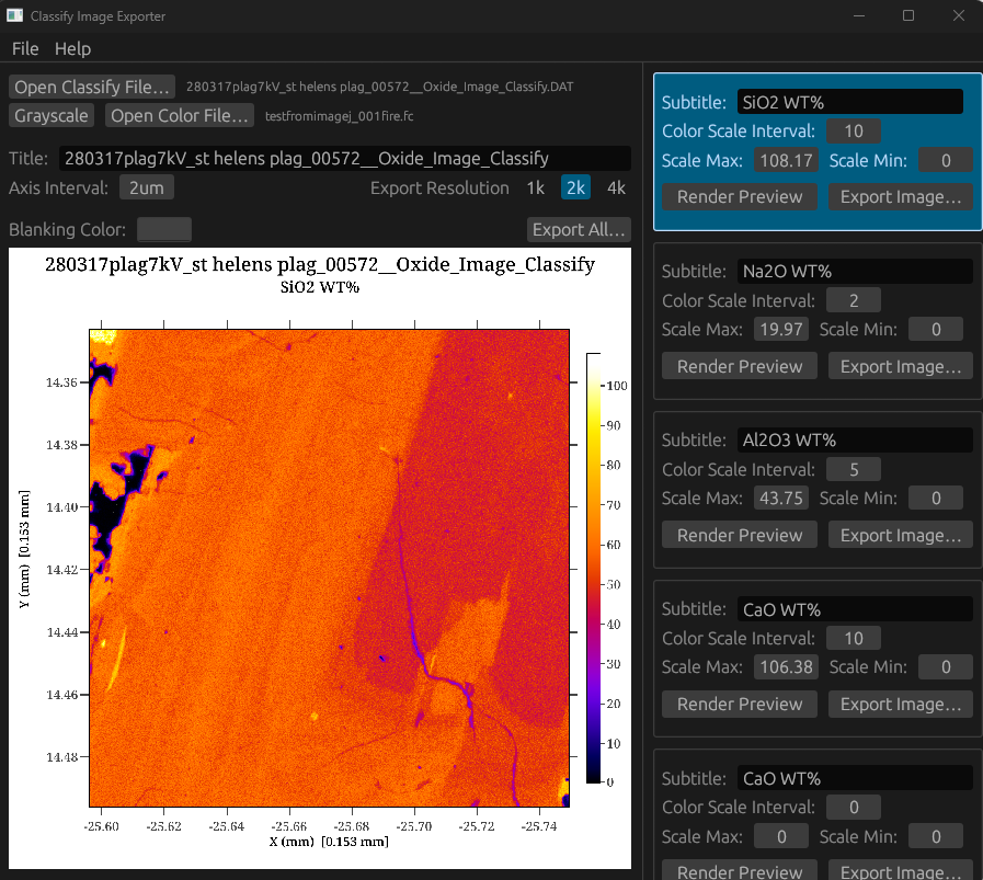

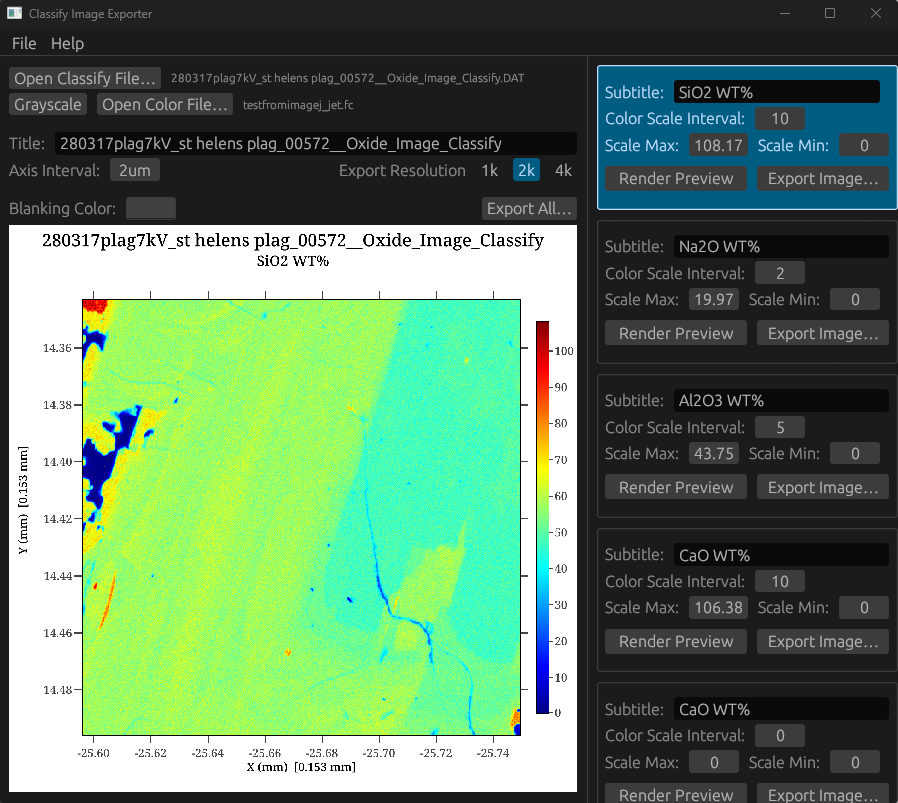

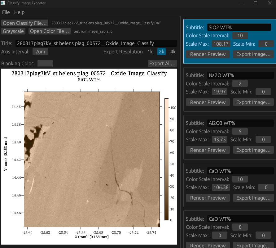

Thank you John, that's very interesting how the different colour palettes developed and what is a high intensity colour. Any chance anyone has the surfer rainbow and surfer rainbow2 as .fc files and could upload here?
Here's a python script for converting ImageJ lut tables (where the format is just 3 or 4 columns of numbers with or without header; not all the lut have the same format) into .fc
import pandas as pd
import tkinter
import tkinter.filedialog
lutlocation = tkinter.filedialog.askopenfile(title="select imagej lut")
savelocation = tkinter.filedialog.asksaveasfilename(title="select save location")
df = pd.read_csv(lutlocation.name, sep="\s+", header=None)
if df.iat[0,0] == 'Index':
    df = pd.read_csv(lutlocation.name, sep="\s+")
f = open(savelocation,"a")
f.write(" False color description for MicroImage"+"\n")
f.write(" BEGIN Items"+"\n")
f.write(" Interpolate=0"+"\n")
for x in range(0,len(df)):
    if len(df.columns) == 3:
        r = df.iat[x,0]
        g = df.iat[x,1]
        b = df.iat[x,2]
    if len(df.columns) == 4:
        r = df.iat[x,1]
        g = df.iat[x,2]
        b = df.iat[x,3]
    rgbdecimal = b * 65536 + g * 256 +r
    f.write(" Item= "+str(x)+" "+str(x)+" "+str(rgbdecimal)+"\n")
f.write(" END Items")
f.close()
sepia
jet
001fire

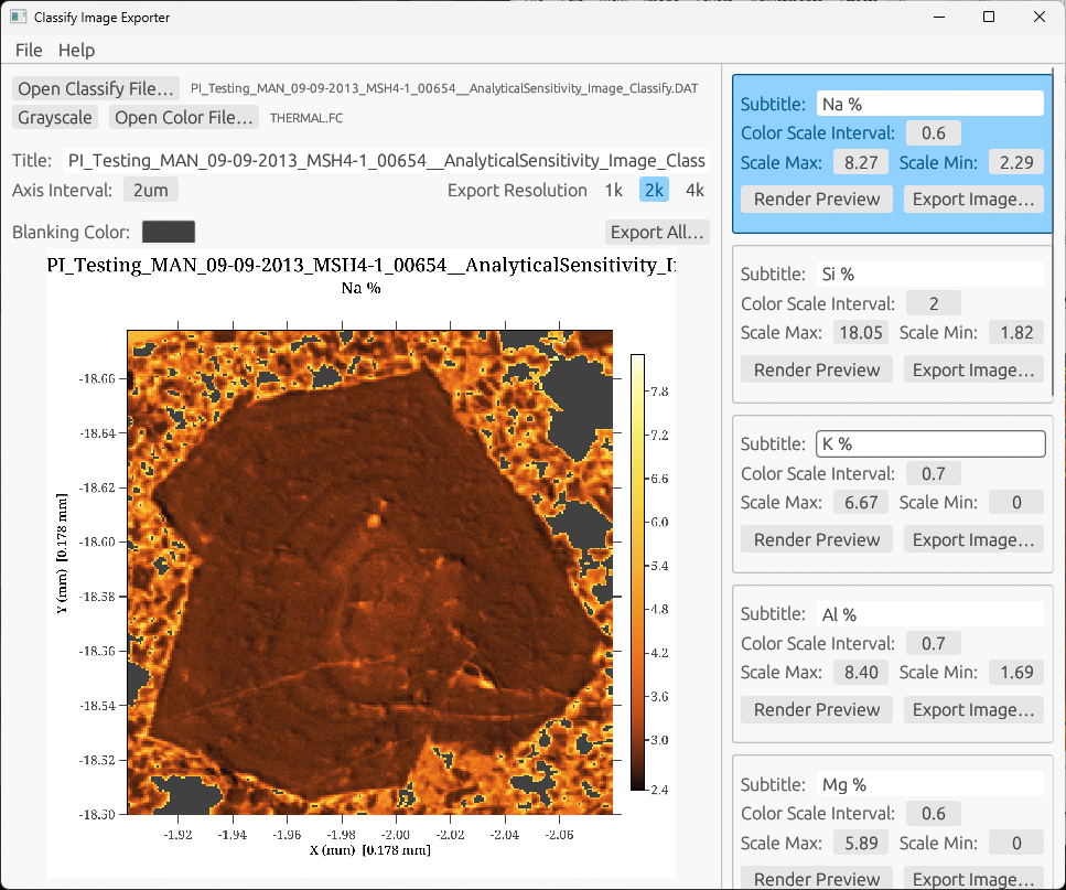

Note that with this Classify Image Exporter app, you can also export other quantitative data from CalcImage such as formula basis maps:
Also note that display of blanked pixels is also supported such as this analytical sensitivity map:

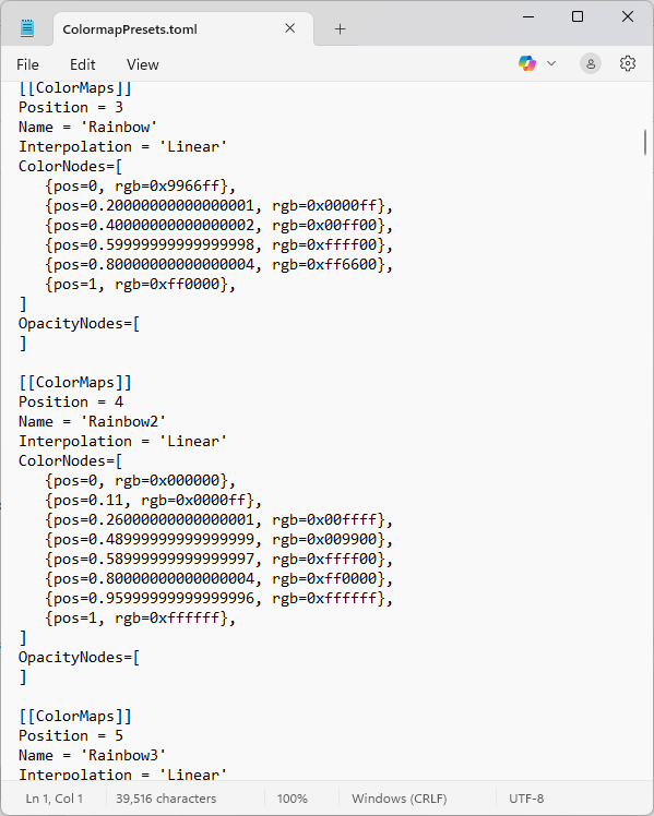

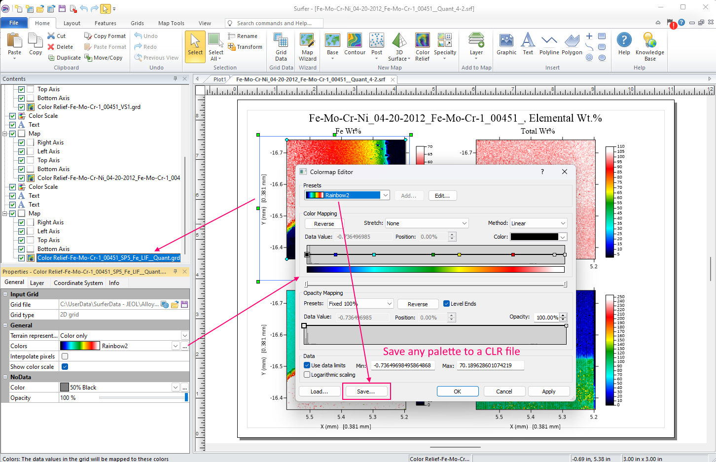

Just FYI, one can save any CLR file from Surfer from the Color Map Editor dialog:
Also note that all the Surfer color map palettes are described in the Surfer ColorMapPresets.toml file located in the C:\Program Files\Golden Software\Surfer\AppData folder:
Finally note this KnowledgeBase article from Golden Software describing how to set a color scale by default in Surfer:
