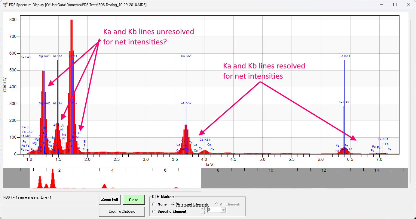

For EDS, there is another elephant in the room - software.  We have never demonstrated that the various different vendors of EDS software produce similar (correct) k-ratios given similar standard and unknown spectra.  It can be hard to know what the "correct k-ratios" are given that most EDS measurements reflect multiple lines and may or may not be directly comparable to single line WDS measurements.  (There is a similar issue with WDS when we assume the peak intensity is a good proxy for the peak integral.)
Nicholas is correct. In a related issue the EDS get net intensity functions that Bruker, Thermo and JEOL provide in their APIs only allow one to specify K, L or M family lines for net intensity extractions.  I think that means that these extracted net intensities combine photons from both the alpha and beta (and other?) emission lines for quantification.
For example, when you acquire EDS spectra in Probe for EPMA, it requests the net intensities for both the unknown and the standard and these are used to calculate a k-ratio that it then run through the matrix correction. So apples to apples right?
Well, not quite, because in Probe for EPMA one must define the identity of the emitting line as either alpha or beta. Of course in the case of low energy low Z elements such as Mg, Al and Si, the alpha and beta lines are completely convolved and cannot easily be deconvolved (even if the vendors offered that as an option). But in the case of higher Z K emissions, the alpha and beta lines are easily deconvolved as seen here:
But that brings up the related issue for quantification: how much of an error is introduced by quantifying the integrated alpha and beta line intensities when running them through the matrix corrections as either K-alpha or K-beta lines?  Because one can't do both since there are different absorption and fluorescence characteristics for the alpha and beta series. For example especially when a major absorption edge lies between the alpha and beta lines...
Since the beta lines of K emissions are relatively small compared to the alpha emissions, I am thinking of an experiment where we acquire L (or even better, M series) emission spectra where the ratio of the alpha and beta emissions are closer to 1.0.
Perhaps mid Z transition elements for L lines (Zr to Cd) or high Z transition elements (Hf to Au, not Hg!) for a pure metal and a binary compound. Such as the NIST Au, Cu, Ag alloys, relative to the pure metals and then we extract the net intensities for each element and quantify them using both the alpha matrix corrections and the beta matrix corrections in Probe for EPMA and see how much of a difference it makes.
Or maybe Se metal and ZnSe...  or Te metal and ZnTe?
Steve Seddio confirms for me that the Thermo get net intensity extraction functions are returning the alpha and beta (and etc.) net intensities of the whole K or L or M families...  so we should look into this.  Anyone interested?
