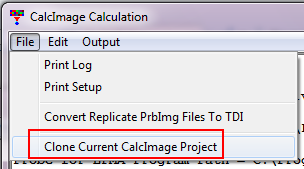

If you update PFE and open the CalcImage Log Window (from the Window menu), you will see this new menu for cloning the current project to another folder. Say for performing multiple polygon extractions from the same map.
The only thing I should mention about this feature is that in the Browse folder dialog, first right click where you want the new folder to be, then click the New | Folder sub menu and name the folder, select it and click OK.  Or just select an existing folder.

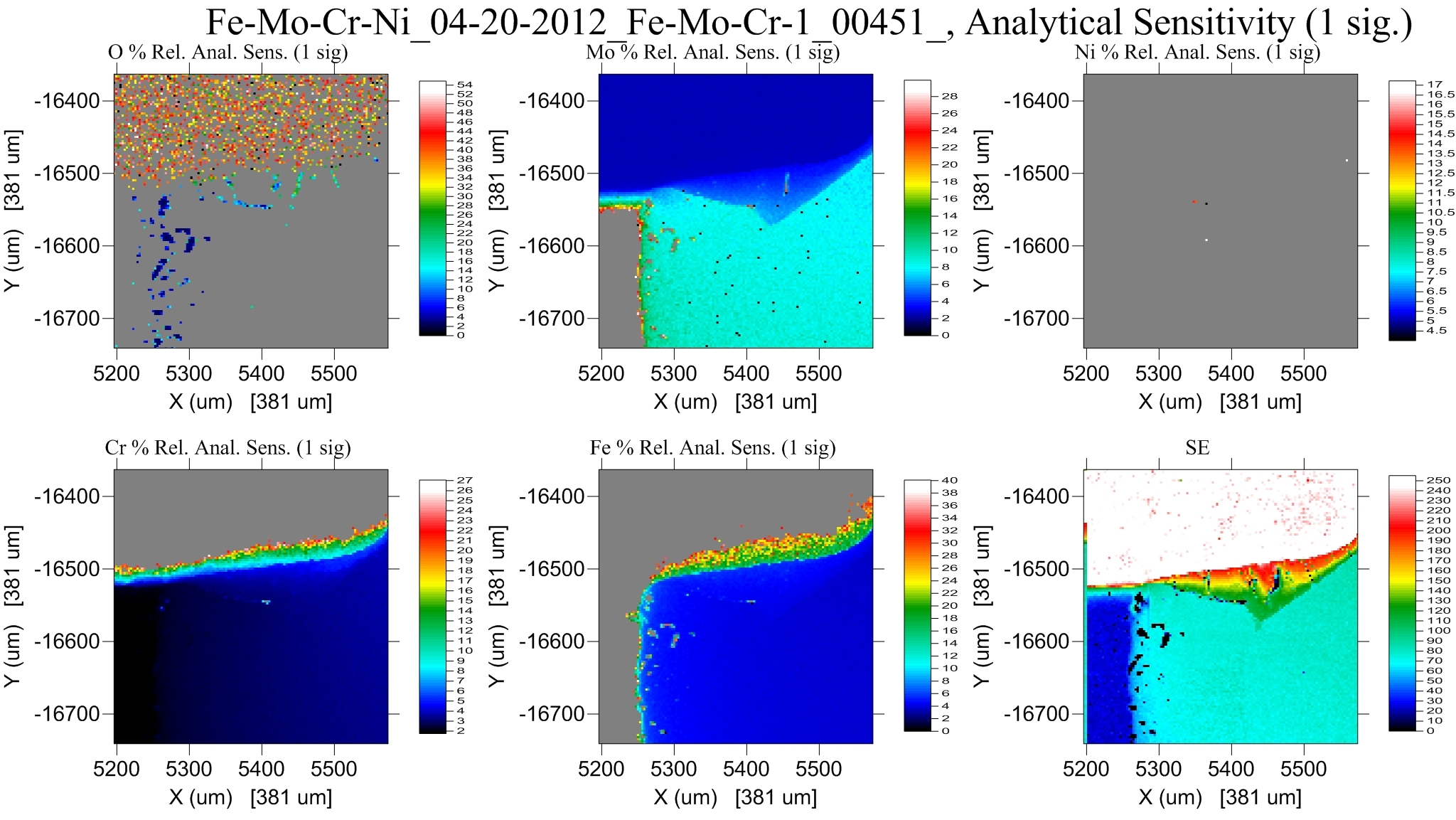

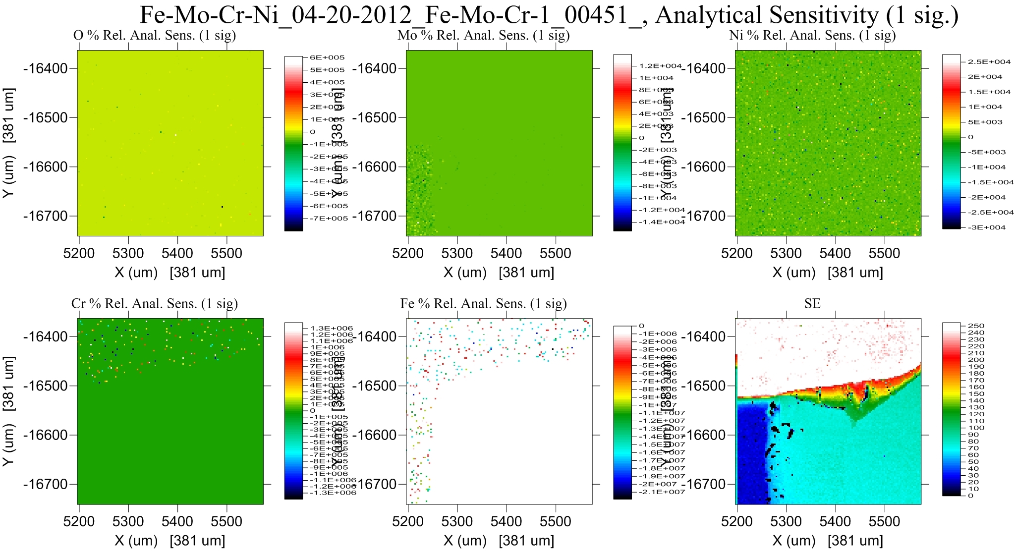

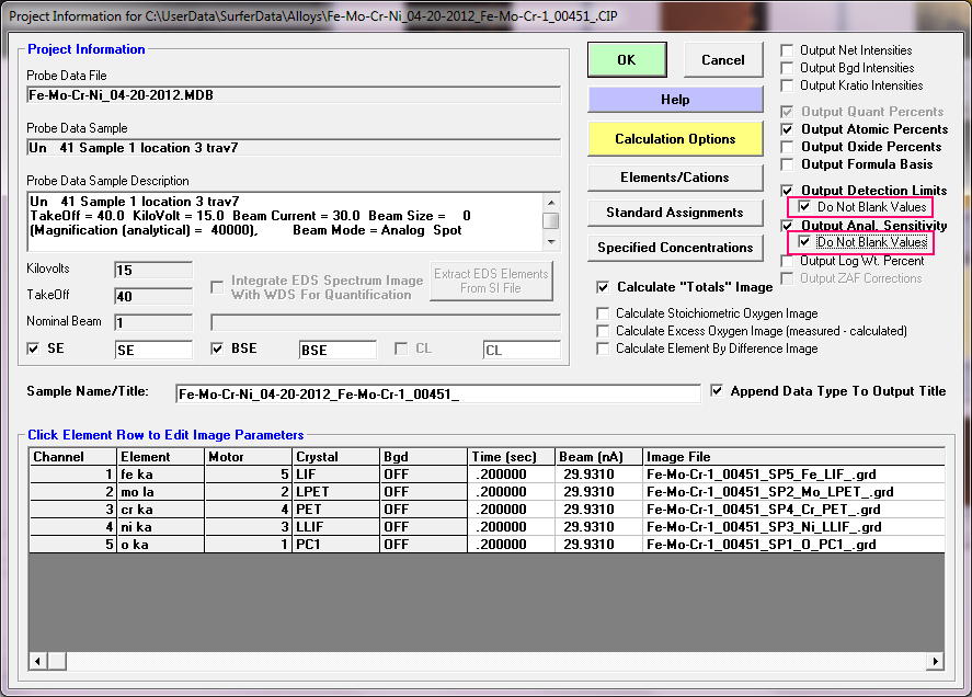

Dave Wark recently asked if I could modify the analytical sensitivity calculation for x-ray maps in CalcImage.  This analytical sensitivity is from Goldstein et al. as described here:
http://smf.probesoftware.com/index.php?topic=93.msg341#msg341
Originally during the saving of the map GRD files I would "filter" the analytical sensitivity calculation so that pixels that represent less than 1 wt.% concentrations would be "blanked" so they would be ignored when plotting them in the Surfer app as shown here:
The reason for this is simple: the analytical sensitivity values (in relative percent) start to "blow up" as the concentrations approach zero, making visualization of the data difficult. If one did not blank these pixels, one would obtain this result when the data is plotted in Surfer:
Notice that many pixels (those less than 1 % concentrations) show analytical sensitivity values over +/- 10^6 percent!  But apparently Dave has some calculations he wants to utilize these values for, so I added some new checkboxes in the quantitative parameters dialog as shown here:

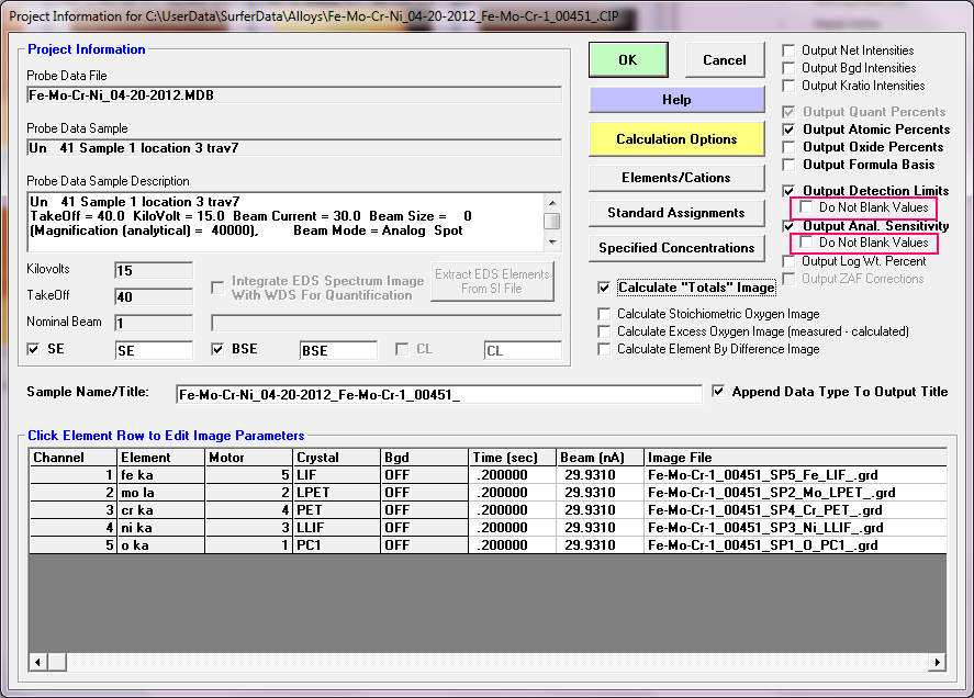

The default (unchecked) is to blank pixels which represent concentrations under 1 wt.%. This results in the original behavior shown in the first plot above. But if you check the box as shown here:
You get the analytical sensitivity data unfiltered for calculation purposes. We'll discuss the effect of the additional "skip blanking" flag on detection limit calculations next.
#25

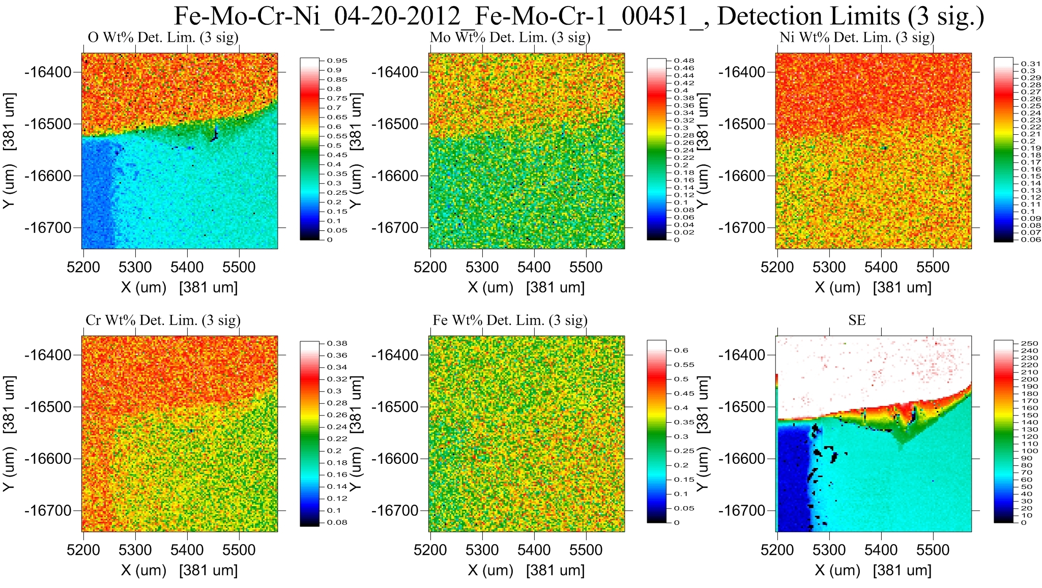

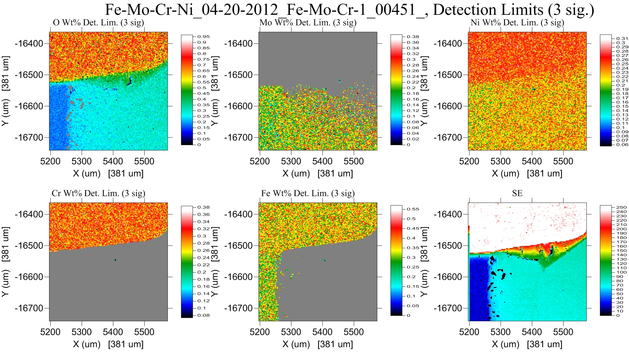

For the detection limit calculation I originally did not blank any pixels, but I wanted the calculation to be symmetrical with the analytical sensitivity calculation, and besides I realized there is a benefit for blanking the detection limit calculation pixels also.
That is, we really don't care about the detection limits for pixels whose concentrations are very large, do we? What we care about for detection limits are low concentration pixels. So I modified the code to blank pixels (by default) if the pixel concentrations are larger than 10 wt.% as seen here:
The value of this method is that the eye can know instantly if the pixel is a low concentration or not for that element, so we can know which areas of the map to focus our attention on.  And of course if one really wants to see the detection limits for all pixels, including high concentration pixels, one can simply check the "skip blanking" flag and get this output for all pixels:
