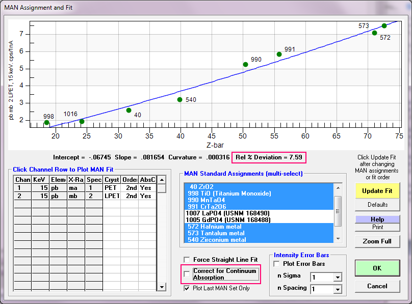

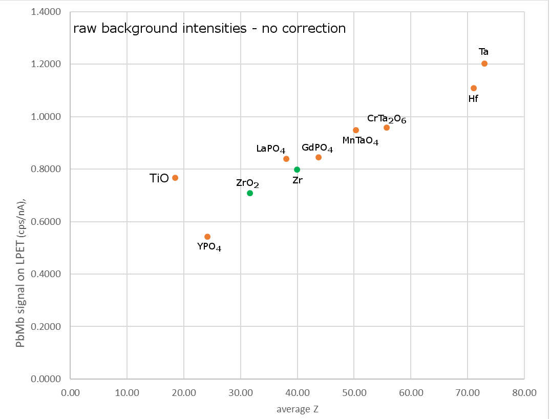

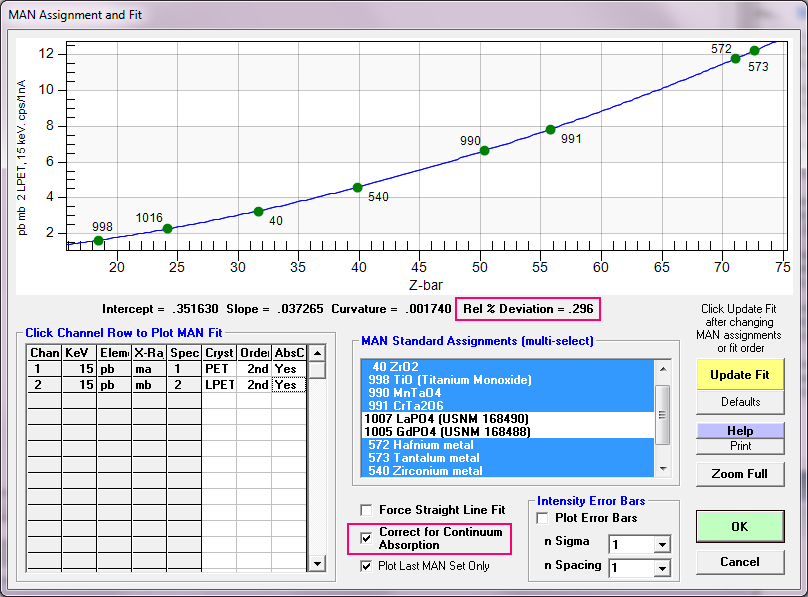

I have been trying to use some advanced measurement (or rather processing) techniques, i.e. multi-point background fitting, interference corrections and (now) mean atomic number background calculation WITHOUT Probe for EPMA (Punk's not dead!). Although it is quite demanding, I have been quite successful in some example tasks (in all these approaches) having only measured intensities, CalcZAF and MATLAB.
Measurement of Pb in my complex material (REE-, actinide-, Zr-, Ti-, Nb-rich minerals) seems to be very complicated. Recently, I have been trying MAN method. So, here I share my experience with fitting the Z vs background curve without PfE, but I also have a question.
I carefully selected some standards for background measurement at PbMb position (c. 58010 on LPET of our Cameca SX100). The intensities were measured at 15kV, 180 nA for 240-300 s.
The approach of how to calculate the continuum absorption is mentioned in Ware and Reed (1973), which is referred in Donovan et al. (2016). However, for better understanding, I recommend a book "Scanning Electron Microscopy and X-ray Microanalysis" by Goldstein and co-workers and its electronic supplement, where the method of Philibert, Duncumb and Heinrich is explained in detail. At first, I tried to calculate their example on NiKa absorption in Ni-Fe alloy in Excel, then I got the same results in CalcZAF. Continuum absorption is calculated similar to the absorption of a characteristic line with the exception of zero concentration of the emitter in the former case. The values of f(chi), which is the fraction of the generated x-rays, which were not absorbed, can be simply and quickly calculated in CalcZAF. First of all I selected Philibert/Duncumb-Reed matrix correction and MAC table (Ware and Reed refer to Heinrich, 1966; however MAC's for PbMb are not published in this set – see below). Then, I loaded a standard from our dataset, e.g. GdPO4. Subsequently, I added PbMb line to the calculation with Pb concentration set to zero. After the calculation, the value of f(chi) for PbMb can be found in results. This approach seems to work well.

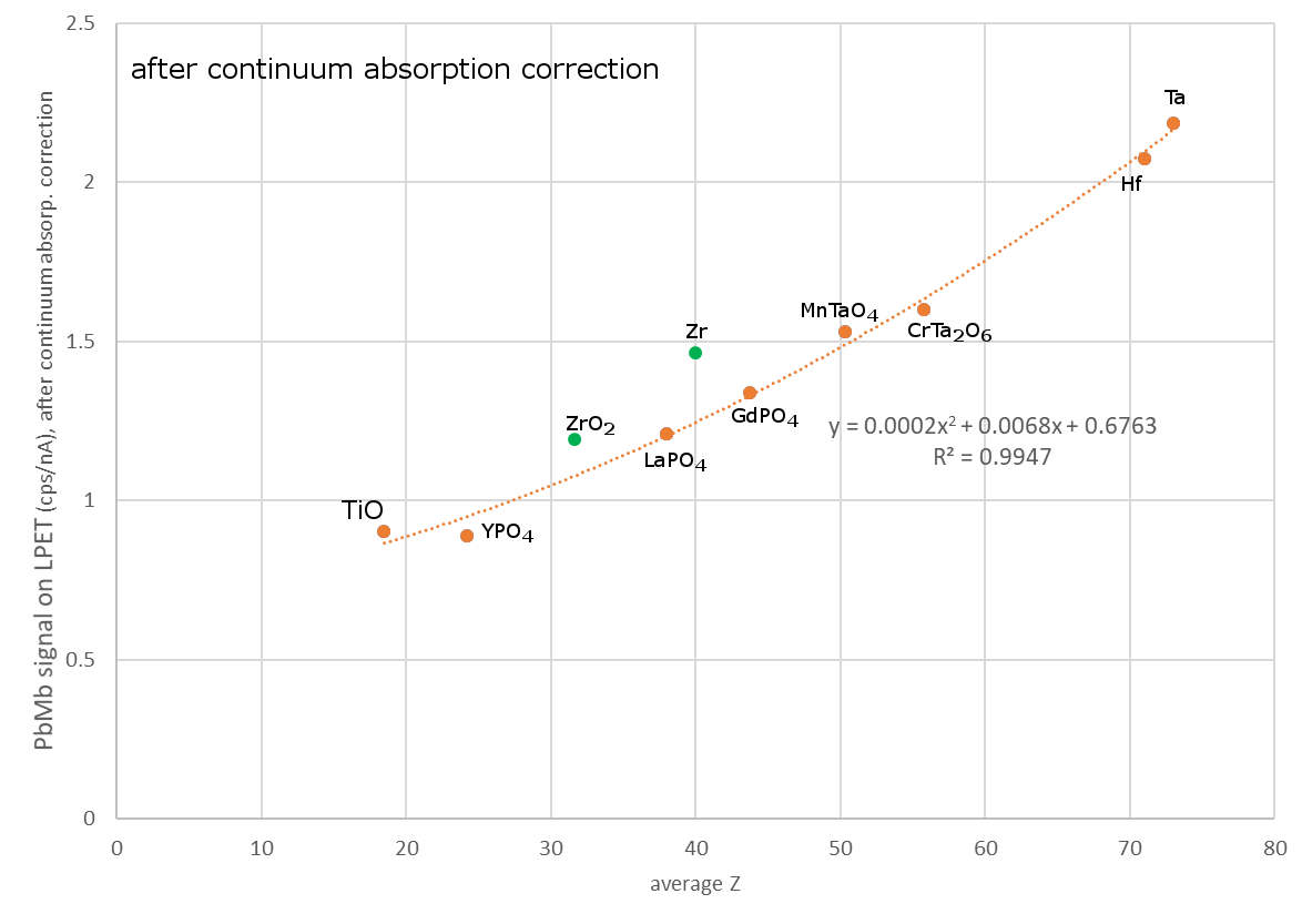

Here is my average Z vs corrected background intensity diagram:

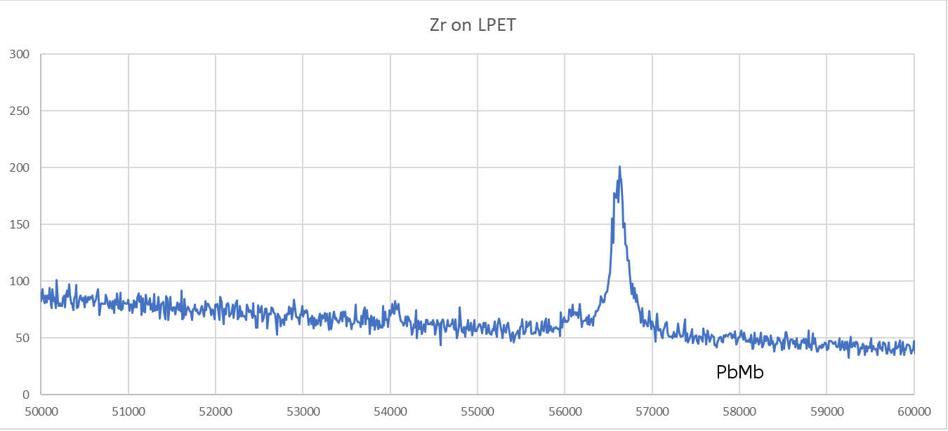

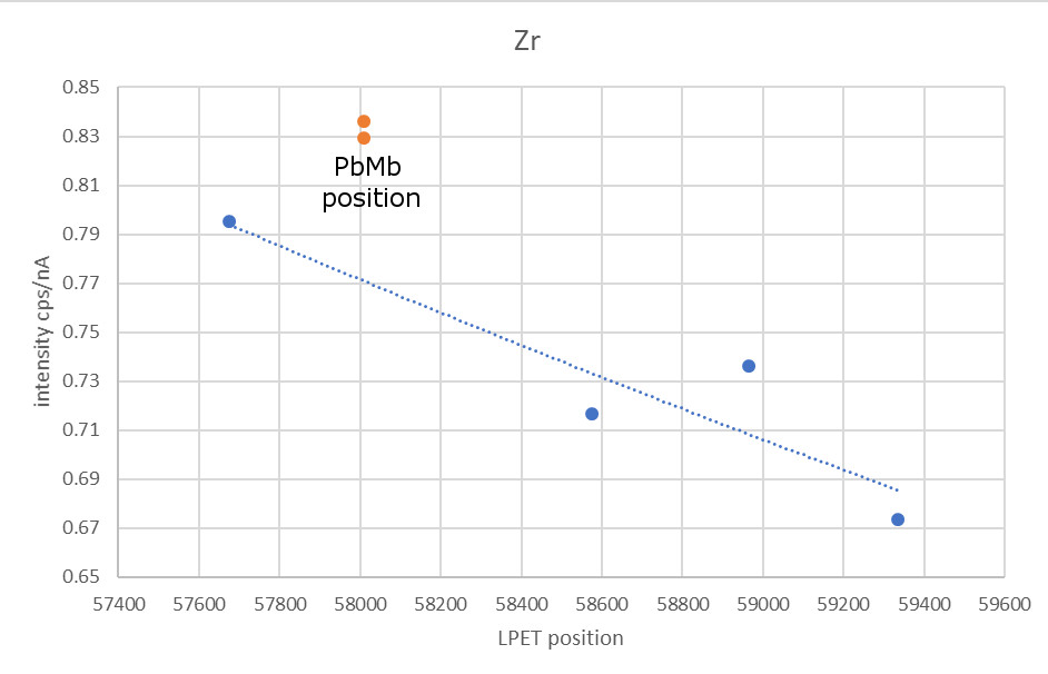

Somewhat enigmatic for me are the deviations of the two Zr-bearing standards, ZrO2 and pure Zr. I have studied a WDS scan of a wide region around PbMb performed on a pure Zr, but there should be absolutely no noticeable zirconium (or some contaminant) peak at that position – according to the scan as well as according to the x-ray spectral database. Any idea for this behaviour?
According to calculated absorption corrections, Zr is a somewhat stronger absorber (f(chi)=0.55) than most other standards, at least those with similar Z. Surprisingly, the raw background intensities before the correction seem to be much closer to the general trend of the most other standards (except for TiO, which shows much higher f(chi)=0.85 = much weaker absorber that the others, which usually have c. 0.6-0.7 or lower).
One observation I find interesting or surprising: I tried to explain the deviation of the Zr-bearing standards in my diagram. So, I decided to compare the values of all the MAC's of PbMb in Zr (originally, I selected Heinrich, 1966) among various datasets. Then, I found out, that there are no values for absorption of PbMb in the dataset of Heinrich, 1966 and CalcZAF automatically took MAC's from a different dataset (McMaster, I think). The MAC's for PbMb in Zr from different datasets, however, are relatively similar, so the backgrounds of Zr-bearing still deviate.
One more question, on PfE – is the continuum absorption correction done using the approach by Philibert (1963) as referred in Ware and Reed (1973) in all cases or can it be switched to a different approach?
Best regards, Jakub Haifler
Department of Geological Sciences
Masaryk University
Brno, Czech Republic

Hi Jakub,
Wow.  Very impressive work.  I must say, I think you would really have a blast with PFE on your instrument, maybe someday?
As to why the Zr containing materials are behaving like this, there are a lot of parameters involved here so it will be interesting to figure this out.  As you point out, the mass absorption coefficient values being the most dominant for this correction. I will have to try some MAN measurements myself, using the Pb Mb emission line, and see what I can see, but in the meantime I will try to answer a few of your questions as much as possible.

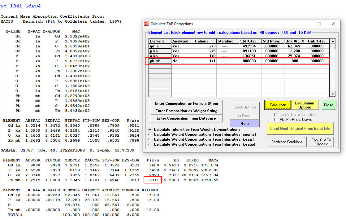

But first I ran a *simulation* of these MAN curves in Probe for EPMA (in demo mode) and got this MAN curve for your standard calibration materials:
Turning off the continuum absorption correction I got this:
Note that stds 40 (Zr oxide) and 540 (Zr metal) both drop below the curve without the absorption correction, so that is consistent with your measurements.  The default MAC table in Probe for EPMA (and CalcZAF) is Henke (for emission lines less than 10 keV). Looking in CalcZAF we can see the MACs for this emission line in Zr:
MAC value for Pb Mb in Zr =    2580.40  (LINEMU   Henke (LBL, 1985) < 10KeV / CITZMU > 10KeV)
MAC value for Pb Mb in Zr =        .00  (CITZMU   Heinrich (1966) and Henke and Ebisu (1974))
MAC value for Pb Mb in Zr =    2750.53  (MCMASTER McMaster (LLL, 1969) (modified by Rivers))
MAC value for Pb Mb in Zr =    2620.36  (MAC30    Heinrich (Fit to Goldstein tables, 1987))
MAC value for Pb Mb in Zr =        .00  (MACJTA   Armstrong (FRAME equations, 1992))
MAC value for Pb Mb in Zr =    2528.02  (FFAST    Chantler (NIST v 2.1, 2005))
MAC value for Pb Mb in Zr =    2620.00  (USERMAC  User Defined MAC Table)
The Henke MAC is quite a bit smaller than the MAC30 table value which you used. So this might cause the over correction you are seeing for the Zr containing materials.

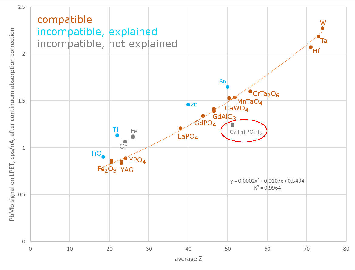

thank you very much for your answer. As you wrote, PfE would be a great help, particularly for such complicated measurements I am doing at the moment. On the other hand, these are extraordinary and are only for my research, I do not perform such calculations for routine measurements. So, the increased effort is acceptable in this case. Unfortunately, I am not powerful enough to affect what software and hardware equipment we have in our laboratory. But as you wrote – maybe sometime. I hope, my little DIY is not going to break your business with PfE  :), but may allow some people, particularly students, to try how the method works.
As for my data: I did some additional measurements. Something is clearer now, something not. I did two 5-point background measurements on Zr (btw, we have two pure Zr standards – intensities in both somewhat differ, but neither is compatible with my MAN curve). I observe that intensities at PbMb position are c. 7% higher than what I would expect from the exponential fit through the other four points. So, some contamination seems to be highly probable (may be Pb, Mo, Bi, Nb... at this position). On the contrary, the theoretical background at PbMb calculated from the fit remains incompatible with the MAN curve.
So, after additional measurements, following 12 standards are compatible within a single fit: YAG, Fe2O3, YPO4, LaPO4, GdPO4, GdAlO3, MnTaO4, CrTa2O6, CaWO4, Hf, Ta, W. I excluded TiO and Ti, as TiKb(II) shows overlap with PbMb. Similar to Zr, Sn also have PbMb-intensity higher than a fit through 4 other points nearby, so the contamination may also occur. Pure elemental standards Cr, Fe are not compatible with the MAN curve (they give higher PbMb-intensities), but I do not have additional data for resolving the reason.
Very mysterious for me is the behaviour of cheralite, CaTh(PO4)2, intensity of which shows very deep "negative" anomaly. It has avg. Z of 51.158, but PbMb-intensity of only 1.24 cps/nA (based on 3 measurements). CaWO4 and MnTaO4 with very similar avg. Z give c. 1.53-1.54, which is the theoretical, MAN-curve-compatible, background value at that Z.

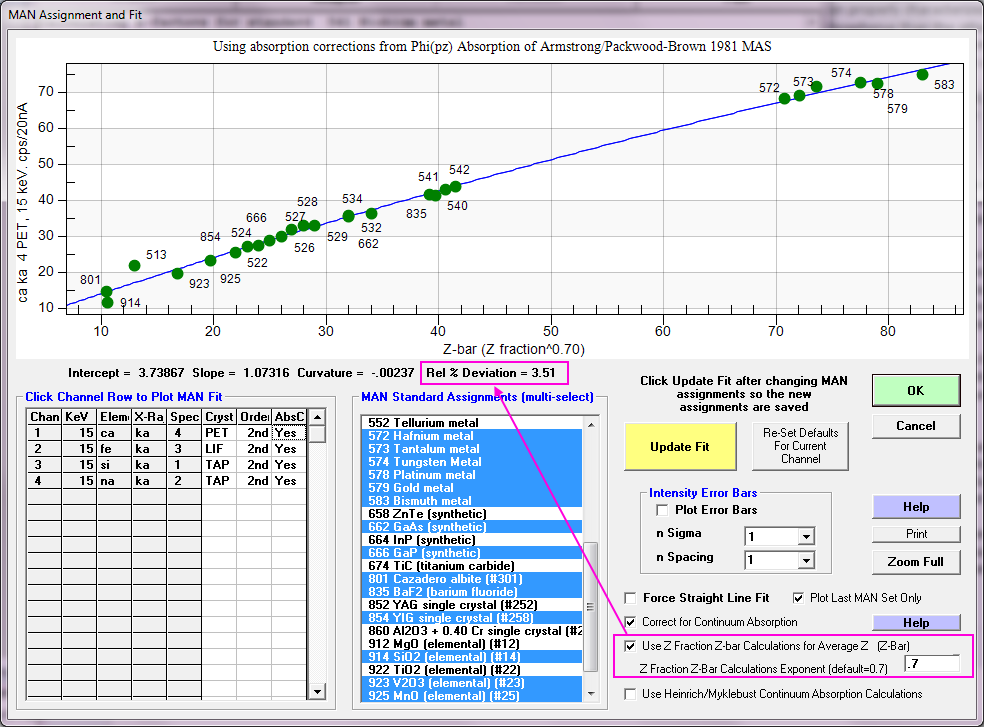

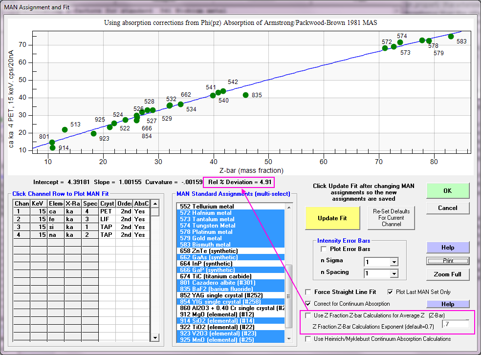

Just wanted to point out that the MAN fit calculations in the Assign MAN Fits dialog in Probe for EPMA can be modified to utilize the more physically accurate electron fraction or Z fraction averaging method. Of course, this only pertains to average Z calculations for compounds.
That is to say, when compared to the traditional mass fraction based methods for calculating average Z. The mass fraction averaging method includes the mass of the neutrons, which has little to no effect on continuum (or backscatter) production, and therefore adds arbitrary errors to average Z calculations. See attached abstract from 2019 below (login to see attachments).
Here is an example for the Ca Ka emitter which is a fairly moderate energy x-ray using the traditional mass fraction average Z method:

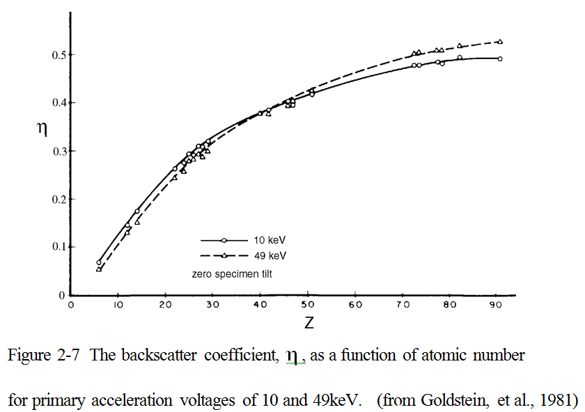

And here is the same data, utilizing the electron or Z fraction method, specifically Z^0.7 electron fraction averaging:
Why the 0.7 exponent? It's because that is necessary to account for the screening of nuclear charge by the inner orbital electrons in higher Z atoms.
In fact this is why we see the backscatter vs. Z trend start to "curve over" around atomic number 30:

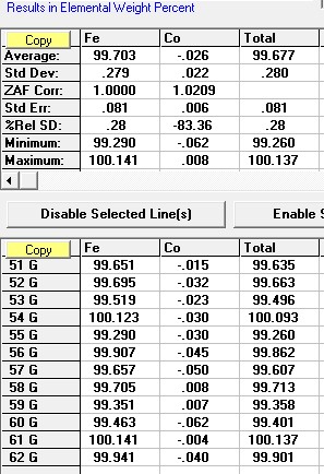

I've found myself in a predicament with MAN background and interference corrections, and I'm hoping someone can point out the glaring error of my ways.
I was measuring Co in Fe-Ni meteorites on our Cameca by both off peak quant points and MAN-corrected quant maps and have come across a disparity with the results for the Co to the tune of around 2000ppm.
As the Cameca is currently busy doing other things, I decided to test this out using our JEOL to see if I could replicate and simplify the problem using just the pure Fe and Co standards.

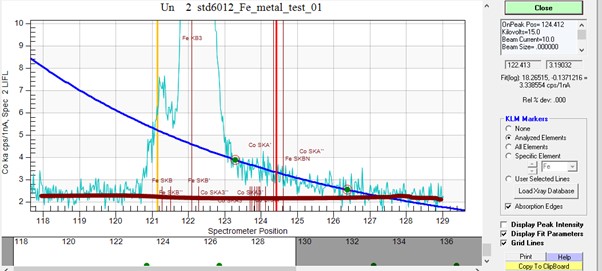

I measured Co Ka and Fe Ka on Fe metal and Co metal using off peak backgrounds. The Fe region is pretty clear and I can use a linear fit between the two background measurements, but the Fe Kb interferes with the Co Ka and the -ve side background ends up moving further up the Fe Kb shoulder.  I could have used a -ve background on the low side of the Fe Kb, but that sits on the other side of the Fe K absorption edge:
Zooming in on the background positions for the Co Ka, the exponential fit still over-estimates the background intensity underneath the Co Ka (as seen with a wavelength scan over the Co Ka in the Fe metal standard):
This results in reporting ~250ppm negative values of Co in Fe metal:

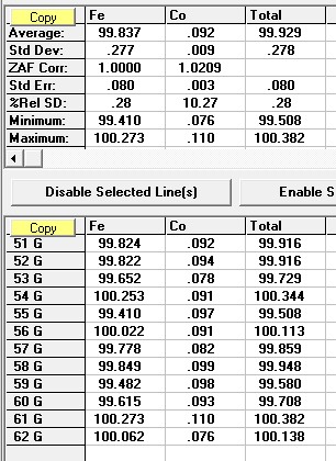

As I'm trying to figure out a solution for data that I have previously measured on the Cameca, I thought to switch everything over to MAN background subtraction.

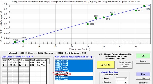

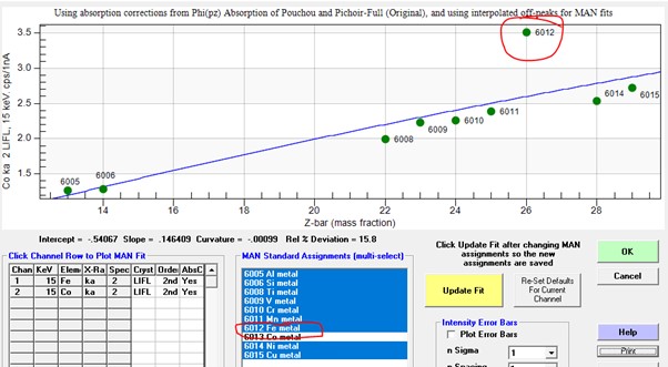

MAN curves look ok:

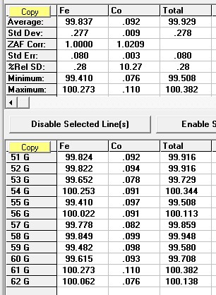

But now the same data as above, that was reading ~-250ppm, now reads +900ppm.
And adding Fe in to the MAN fit highlights that I've either (i) got Co in my Fe standard, or (ii) there is an Fe interference on the Co Ka.
I don't think there is 900ppm Co in my Fe metal standard, and looking at the user's data, I have acquired MAN calibrations on fayalite, pyrite and hematite alongside Fe metal and all show elevated Co content proportional to the Fe content of the phase.
Looking back at the wavelength scan of Co Ka in the Fe metal standard, I can see that there are two components to be subtracted from the Co Ka intensity: (i) the Bremsstrahlung background (roughly drawn on in maroon, and across the Fe K absorption edge) and (ii) the Fe Kb shoulder:
At this point, you think "that's easy, just add the Fe as an interference correction on the Co measurement!".

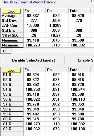

The Fe metal results with Fe interference correction on Co:
And without Fe interference correction on Co:

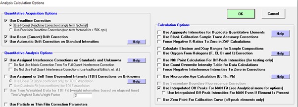

"Use Assigned Interference Corrections on Standards and Unknowns" is enabled globally:
And I should add that I have tried both with and without "Use Interpolated Off Peaks for Man Fit".

I just quickly read through your post and think I understand what is going on. Specifically, the interference corrections are *not* applied to the MAN fit curves (it is possible to do in principle of course, but we have not implemented it).
What you want to do is remove all standards containing Fe from your Co ka MAN curves (use <ctrl> click to deselect them and click the Update MAN Fit button) because, yes, Fe Kb does interfere with Co Ka.
The other thing to keep in mind is that the *accuracy* MAN bgd correction is limited to around 100 to 200 PPM in the silicate-oxide z-bar range (10 to 20 or so), and is slightly worse for high average atomic number materials.  So depending on your accuracy needs, this may be where the blank correction needs to be applied to improve accuracy further. See:
https://smf.probesoftware.com/index.php?topic=307.0
and
https://smf.probesoftware.com/index.php?topic=29.0
for more details.   Or did I miss something?
I think the issue is that the interference correction isn't being applied to the MAN background subtracted measurements (that were acquired with off peak background measurements).
The MAN curves look good to me, and I've removed all the Fe-bearing phases from the Co Ka MAN fit.

Hi Jon,
You can see the magnitude of the interference correction for each element, in the log window output. Look for the line labeled INT%.
Note that depending on the situation you don't necessarily require a perfect matrix match for the blank correction. However, you should not attempt to correct an interference correction using the blank correction if you are already applying an interference correction, or you will get a double correction (the software should warn you about this I think).
Feel free to send me your MDB file and I can take a look.

  Thanks for looking at this for me. I've been scratching my head about this for the last two days and I can't figure out where I've messed up!
I've not had a problem with either MAN or interference corrections before, so I'm lost as to where I've gone wrong. And then doubly confused that I've managed to do it again on a completely new setup on a different instrument!
Having checked that "Use Assigned Interference Corrections on Standards and Unknowns" is enabled in the Analysis options menu, I recalculate the Fe metal "unknown" and get the following:
Un    2 std6012_Fe_metal_test_01
TakeOff = 40.0  KiloVolt = 15.0  Beam Current = 10.0  Beam Size =    0
(Magnification (analytical) =  40000),        Beam Mode = Analog  Spot
(Magnification (default) =   100000, Magnification (imaging) = 100000)
Aperture Number: 2
Number of Data Lines:  12             Number of 'Good' Data Lines:  12
First/Last Date-Time: 05/06/2021 07:27:49 PM to 05/06/2021 07:49:53 PM
WARNING- Using MAN Background Instead of Off-Peak Background Correction
Average Total Oxygen:         .000     Average Total Weight%:   99.928
Average Calculated Oxygen:    .000     Average Atomic Number:   26.001
Average Excess Oxygen:        .000     Average Atomic Weight:   55.850
Average ZAF Iteration:        2.00     Average Quant Iterate:     3.00
Un    2 std6012_Fe_metal_test_01, Results in Elemental Weight Percents
ELEM:       Fe      Co
BGDS:      MAN     MAN
TIME:    20.00   20.00
BEAM:    10.00   10.00
ELEM:       Fe      Co   SUM
    51  99.817    .099  99.916
    52  99.816    .100  99.916
    53  99.645    .084  99.729
    54 100.247    .097 100.344
    55  99.404    .103  99.507
    56 100.016    .097 100.113
    57  99.772    .087  99.859
    58  99.843    .105  99.947
    59  99.476    .104  99.580
    60  99.609    .099  99.708
    61 100.267    .115 100.382
    62 100.056    .082 100.137
AVER:   99.831    .098  99.928
SDEV:     .277    .009    .278
SERR:     .080    .003
%RSD:      .28    9.62
STDS:     6012    6013
STKF:   1.0000  1.0000
STCT:   817.76  878.02
UNKF:    .9983   .0010
UNCT:   816.43     .84
UNBG:     1.83    2.43
ZCOR:   1.0000  1.0209
KRAW:    .9984   .0010
PKBG:   446.56    1.35
INT%:     ----    ----
I see the INT% is recorded as ---- despite the interference correction being selected?
I'll email over the mdb file to see what you think.
Hi Jon,
Be sure to use the "Tt" button for text output so the columns line up!
This is a silly question but did you actually assign the Fe on Co interference in the Standard Assignments dialog?
Quote from: John Donovan on May 07, 2021, 10:52:54 AM
Just looked at your MDB file and yeah, you didn't actually assign any spectral interferences!    :o
I mean the software is good, but it can't read your mind!   :P
